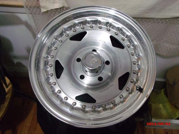

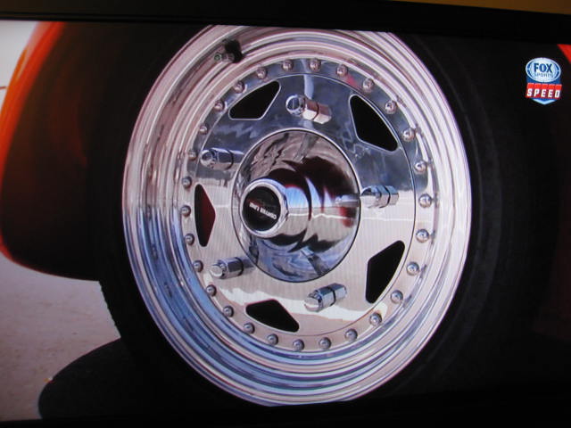

On a sidenote with the centerline wheels - correct me if I'm wrong, but didn't the convo pro wheel ONLY come with the convoluted ridges that we all hate to polish? I was watching Pass Time a few nights ago and a car rolled up with wheels that looked like Convo Pros, but there were no ridges on the inner lip. Also, the bolt holes were farther out towards the wheel's outer edge. I took a photo of the TV to compare. The wheel even has a centerline center cap. Has anyone ever seen these before? I would love to buy a set without the ridges like this if they're strong enough for street use. I've included a photo of a normal convo pro new out of the box from a craigslist ad for comparison.
Pretty large bolt circle on that first wheel. Wonder what the hubs are from?
That's early Volkswagen beetle bug.
yup, what Rusty said - I saw that bug with those on Pass Time.
