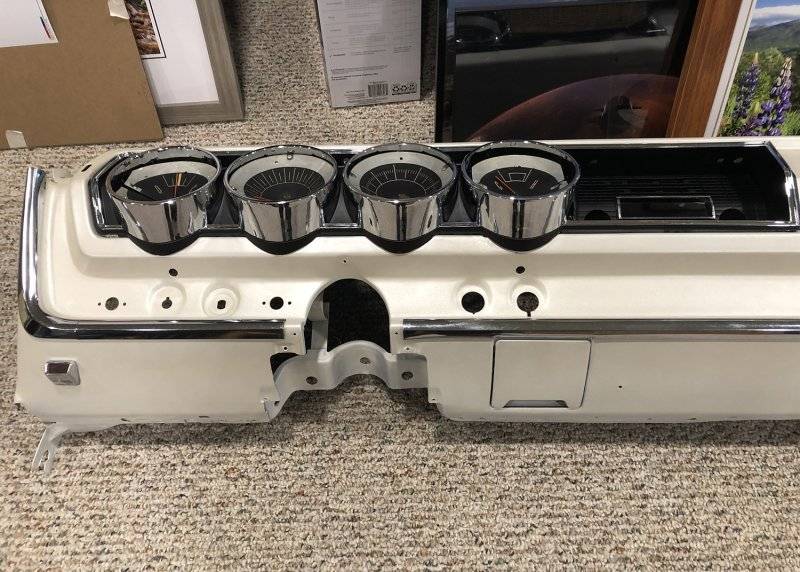

As I mentioned earlier, you can make the aftermarket pieces work, you just have to know where to trim them so they physically match the originals. It's pretty straight forward, but it's also quite tedious. I've done it... In fact I did a post on this over on the 66/67 forum.
Was it worth it? Time will tell... I know the first aftermarket pieces that came out suffered from paint issues. They painted the black on top of the chrome without proper prep. You can't paint over chrome and expect it to stick there forever. Consequently, given enough time, the black paint would start peeling off these units. I have been told by various retailers that this was a known issue and that the issue has been addressed by the manufacturers.

Here's a couple of pic's of the aftermarket bezel I trimmed to fit. All the trimming was done on the lower flange and surfaces. The top flanges etc were all fine. Time consuming...hopefully it will last.
