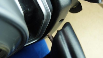

About 2 years ago I bought a new dash pad from http://www.beaparts.com
"66-67 Charger black dash pad. Constructed with foam covered steel frame and vinyl covered".
It doesn't fit, it's 1 inch too short between the bolts from outermost left to outermost right.
- Had I lived in the US I would have returned it, but that's probably not an option now.
I see 2 possible alternatives to fix it:
1. I cut off the outermost bolt at each end and just use the remaining bolts.
2. I apply heat to the ends and try to bend into a shape that would fit.
What do you think guys?

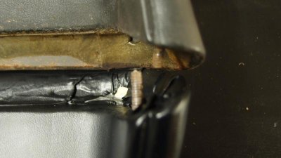

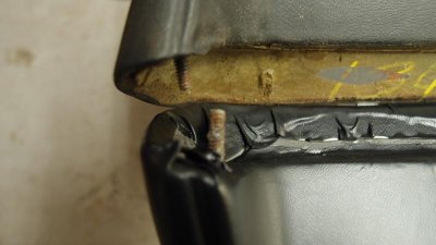

I put the new and old one side by side on a table and managed to press one end out to the correct position. It bounces back to the incorrect position of course, but I think with the help of a strong friend it might be possible that we can bend it into the original holes.
Here you see new and old side by side...sorry for crappy focus...

Yes, Mike suggested I should bend it enough to make it fit. I guess that is what I have to do.
Thinking about some simple tool that would allow me to bend both ends outwards simultaneously. I think/hope it will be okay once I get it into the holes.

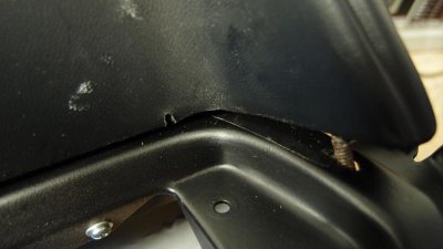

Okay, I bent it enough to get it to fit, and the vinyl cracked in the inner RH corner. The LH corner was close to cracking as well, the vinyl stretched so much that it changed color to a lighter black...
Clearly I'm unhappy with the quality of this dash pad...which I'm sure would have been unsellable in the US. I can't refrain from thinking that sometimes it's convenient to send a locally unsellable product to a country far away...
I have received locally unsellable products before, remember especially a high-priced product showing marks that it had been mounted by a customer, who then returned it due to a manufacturing flaw...but it still ended up in a shipment to me...However, the company quickly shipped me an additional flawless product at no cost.
Hmm that does not look great. Mine was no where near that difficult. And now it fits like a glove as I said.
Damn that sucks big time. It obviously is a manufacturing flaw. Perhaps with the call you made and the pics here showing the poor fitment, they will be willing to step up to the plate and compensate you somehow. I would hate to believe that "they" would take advantage of overseas sales. But who knows? In today's day and age nothing would be to surprising.
