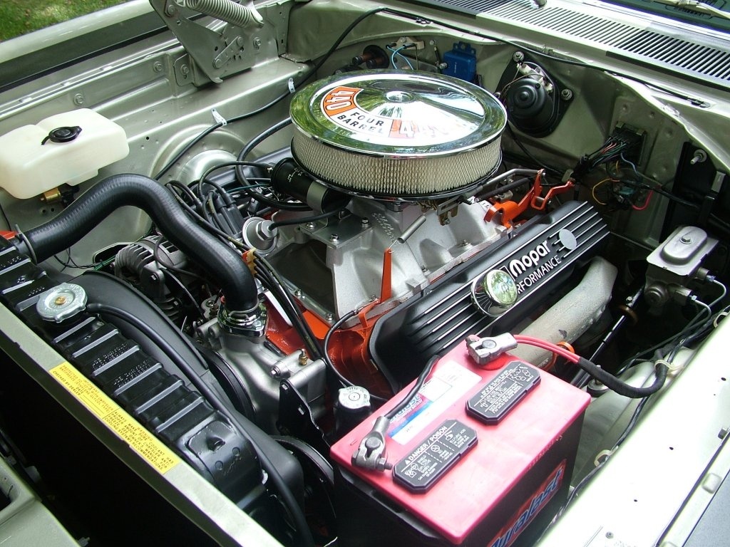

I just did a 440, Weiand dual plane 8009, Stealth Heads...
Similar combo on my 67 GTX

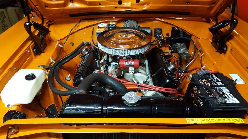

I have the same set up on my 69 GTX. 440, performer rpm intake, 750 eddy carb. Had to go with a drop base air cleaner from eddy. I think it was a 1 1/2" drop base. If you get to much drop it may interfere with the throttle linkage and electric choke.

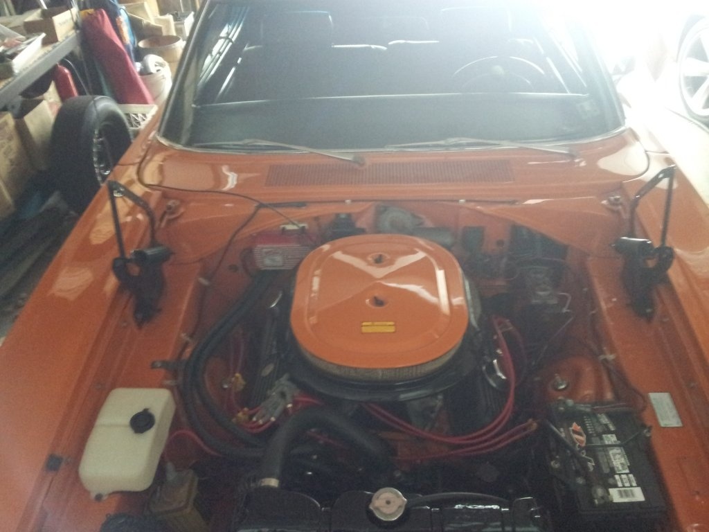

Last picture is with stock air cleaner. The 3rd Picture is what I have to run now because stock won't fit. I would like to stay with this stock set-up.

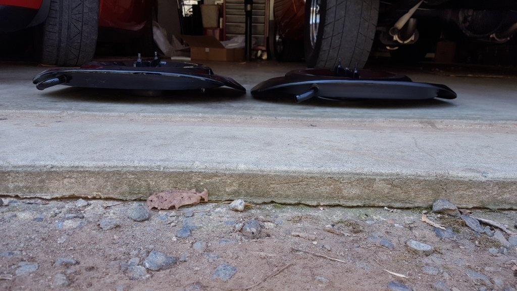

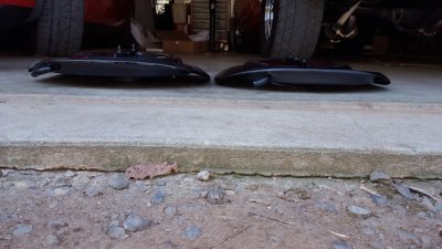

left baseplate is 383 right is 440
