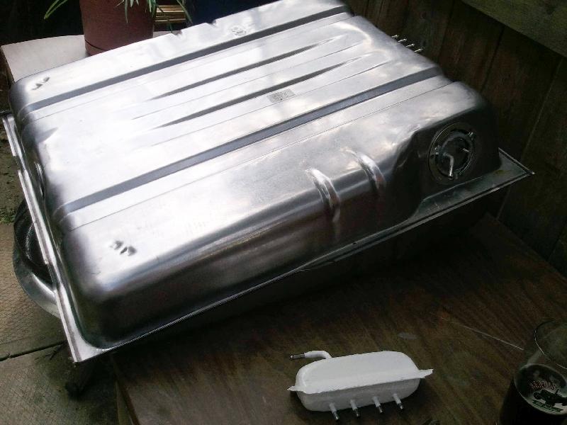

Mine is a 74 but took the hump out of the trunk floor and went with a CR10B tank for a 73. That tank has 4 ports which have check balls/floats to prevent fuel from coming out into the small vent tank (I dont know what its actually called at the moment) which could get blocked, there is also a check valve in that small vent tank...
Sorry I cant explain it real well. I will post a pic I have of the setup tonight.

Well hell I cannot for the life of me find the resourse I had put somewhere grrrrr
In any case, here is my tank before putting it in. Each of the 4 vents also have a line on the inside of the tank going to each top corner on the inside of the tank. you can see the pinch dimples on the top of the tank near each corner. I beleive that there is a check valve in each of these to prevent fuel from coming out however apparently not all four will be blocked by the valves at any one time (yes I said apparently lol because thats what my documantation by ma mopar I cant find said) The white thing you see in the pic is called a separator and also has a check valve on the line that goes to the front of the car to the charcoal canister... THIS ONE WAS STICKING on the one I used, I also had to apoxy it because it was rusted out.
I hope this helps you. Sorry I cant find them other docs right now but I'll continue looking
