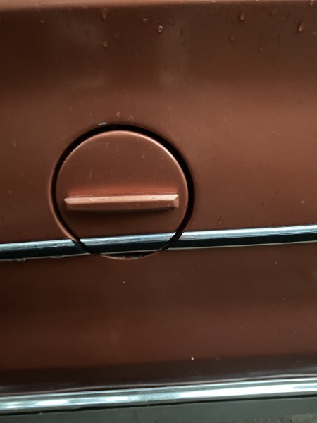

Recently purchased in 1967 Plymouth satellite with a new gas tank installed. If it sits in the sun at all with only a half a tank, it leaks gasoline around the filler tube and the cap is pressurized. when I remove it at spills out gas. Do I need a vented cap or was the gas tank Supposed to be vented? Thanks for your help.

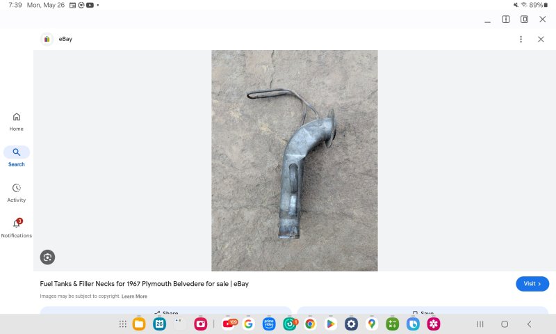

It should be vented. Look for a small tube (brake line size) near the fill tube in the trunk.
