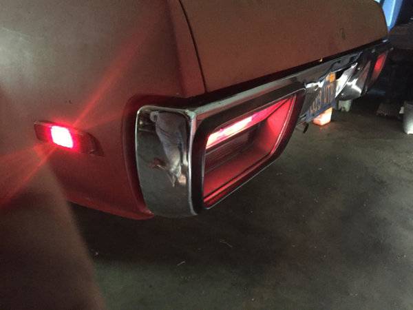

Still fighting a ground fault when the park lights are engaged. Can't figure it out as of yet. I had the lights going just fine for a few minutes and then after a test run, the fuse burned out, and haven't been able to get them back on. Not sure whats up.

On you light issue, check the bulb sockets for corrosion between the housing and socket. Make sure they are all grounded to chassis. They may look fine but may not have good contact. Grounds are the first place I would look.
