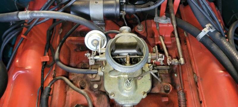

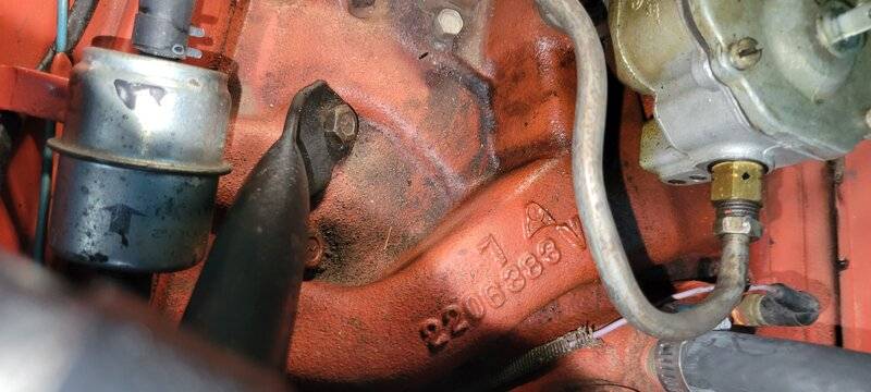

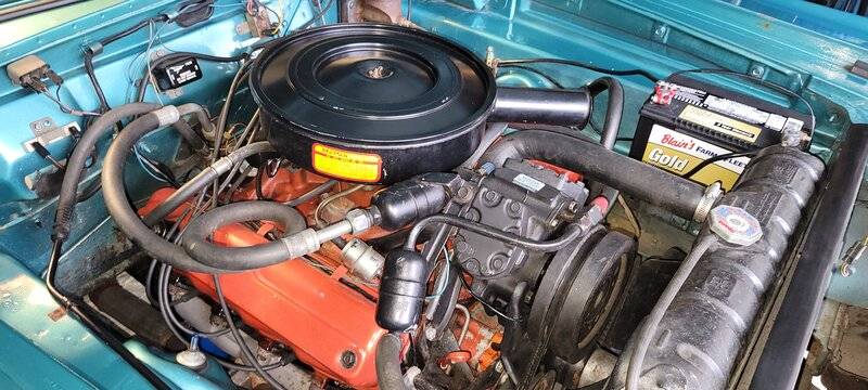

I just got a 64 Polara 500, 318 Poly, 2 barrel carb,all original except wheels tires and exhaust
I'd like to get either 4 barrel carb or efi,without disrupting originality too much

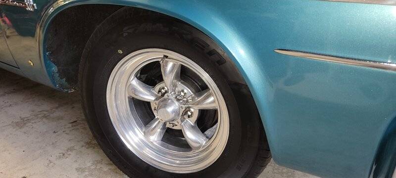

Also, I have 15" American Racing 5 spoke wheels and would like to change front drums to disk
I've got like 13 1/2" clearance on inside of rim
Anyone have suggestions for setup?

Love your Dodge and especially the POLY. You may hear, as I have, and many other POLY owners, ditch the POLY and drop in a BB. My response has always been, 'why'? You'll hear that they are too expensive to build, no speed parts, headers cost $900, and except for the headers the rest is not true.

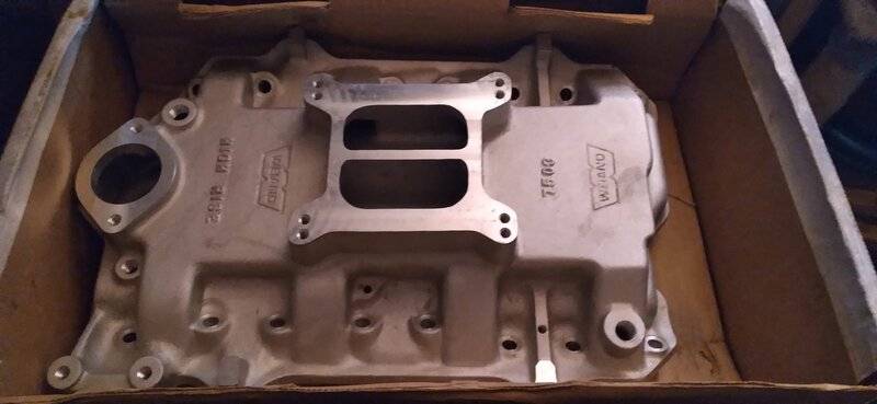

About the 4 brl.... intake manifolds are a little hard to find. They're out there but can be a little pricey. Weiand made one but it is a single plane manifold and IMO does not perform well. The original cast iron manifolds, although they weigh about 60 lbs are a far better manifold. Expect to pay $400/700 for either. If you find a cast iron manifold you will probably need a carb adapter. My 1956 cast iron square bore needed a Transdapt adapter plate. And, of course, if you switch to a 4brl, plan on redesigning the throttle linkage.
There is another option. A 500cfm 2 brl carb on your stock 2 brl manifold. This set up out performs a stock cammed POLY 4brl. There are posts about this on the Facebook Polyspherical AKA Poly 318 group. Try searching David Grow ll in that group. They also talk about EFI there. Another thing that will wake up your POLY is a nice 264/284 Schneider cam. It will do wonders.

I suggest you start with the brakes.
Stopping is more important that starting.
Definitely change to a dual master cylinder and replace the rubber lines.
I used an SSBC conversion on my Charger and they are easy to install and work pretty well, with a manual master cylinder.

I converted my Polara to disc brakes many years ago using parts from a junkyard 1970 Roadrunner. I had to swap spindles side for side to hang the calipers at the rear to miss my sway bar.I
