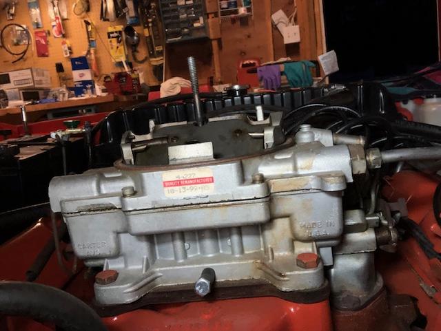

Hello Gang, my '71 road runner caught the bird flu and I don't know if it's fuel or ignition. I have a Carter AVS 4966S that was remanufactured then rebuilt recently (March 2023) by Dave Woodruff (Woodruff Carburetor Specialties advertised here at FBBO). At that time when I got it back I popped it in along with the distributor I sent him (he also put a curve in my distributor) and it ran great. But now after 2+ years my distributor is getting worn (shaft bushing) so I replaced it from halifaxhops (Ray Brenner also from FBBO).

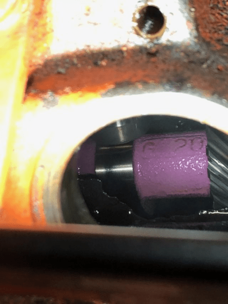

My bird is stock except for a purple camshaft that I have no specs on - I just want it to start up cold and hot, run good from idle to wide open and overall for street cruising, NOT racing! So my questions are:

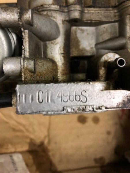

The 4966 is a low performance carb used on C-bodies. A new 650 CFM AVS2 would be a nice upgrade if the issue you have is carb related. What is your ignition system? Points, electronic? Whats the timing set at?

Thanks T2R9 for the carb info.

[1] Your rough idle at low speed/idle is probably the cam [ part # or specs? ]
[2] Your #4966 can be tuned to work.
[3] I suspect the cam duration is causing much of your problem. Remove the carb & turn it over. Check how much slot is showing below the pri throttle blades at idle. I am betting it is more than 0.060", which is no good.

[5] 10* initial is nowhere near enough for a purple cam. More like 20-30*. This is a most misunderstood topic, even amongst experienced mechanics.

I do agree your existing carb should be good.
Fix your ignition and I think it will run well.
The Edel AVS does have a benefit over the original Carter AVS in my view. Whether it is worth the $$$ is up to you. Edel added venturiis to the secondaries; the Carter AVS just had discharge tubes which had a specific engine calibration. These tubes had holes in them for the fuel to discharge & the holes varied in size & position. Obviously, once you move too far way from the original specs, the calibration will not be optimal. The Edel is more 'universal' & I would use the 650, NOT the 800 cfm model on a 383.
