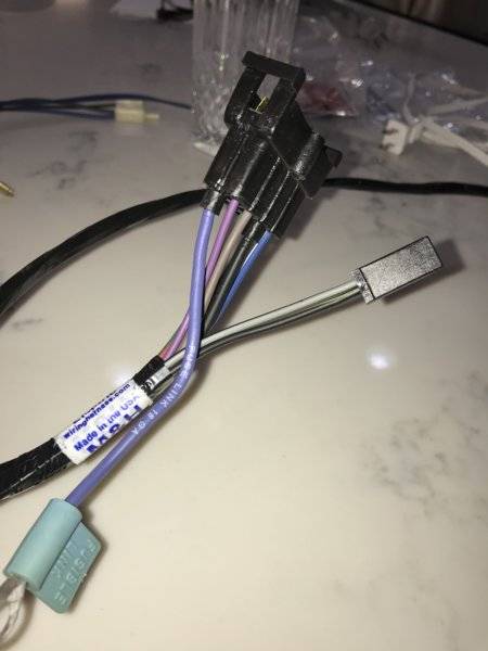

I am upgrading my engine wiring harness for my 70 Belvedere. I just got a new engine harness from M and H electric fabricators. Can anyone identify the two wire plug in this picture that is a gray wire with black tracer and a black wire with a yellow tracer? It’s the same length as the fusible link wire and there’s not one on my original harness.
Looks to me like it lands on the start relay...You need to consult your wiring diagram to be sure..where are the other ends of those wires? Lay the harness out in the engine bay if you have to and see where they want to go..
for optional turning lights on hood or fender ? black yellow traced uses to be code for parking lights thought
Nacho is correct on the colors..that connector at the same point as the bulkhead connector is what's confusing to me, looks like it's made to plug into something right near the bulkhead on the firewall apparently.
The black and yellow wire on the other end is in the five prong plug at the unit.The other wire goes to the negative side of the coil.
I don't know If I'm right, but just thinking out loud LOL.
Black traced yellow is the code for - lead of coil from ECU too LOL
So the question is is it OK to run the engine with this wire unplugged? They are wired together.
ok... points cars gets the dist straight to - lead of coil.
If there is not other wire around to conect to - lead of coil from ECU, should be that one... so the car won't run without that plugged. But what thought M&H to reach the coil from that plug ?
that signal could be used to tachs thought!
Well then that sheds a little more light. Typically the wire from coil(-) goes straight to the ECU. So if you don't plug that connector in to anything, that's basically what you have...the plug is just a splice point..Beats me why they'd do it that way but they build them for a living, not me..
next question is... so we know the black traced wire reachs the ECU plug... but the other one ?
so the car starts and runs fine. However, I still can’t get the alternator to charge the battery. I have replace both the alternator and the wire harness, so what else could be keeping the battery from being charged? My voltmeter on the battery says 12.3 with the engine running. It should be 14 point something correct ? Maybe it’s the bulkhead connector?
Negative side of the coil.
Oh Ok, Dunno why I thought both wires got diff terminals into a two way plug!!!... so that is a single terminal with both wires spliced into... definitelly must be to plug a tach to the interior of the cabin.
with the new harness did you get also electronic regulator upgrade wiring and plug ?
how many prongs got yout alt, and how many wires got the harness ?
Thanks for asking. The new alternator has two poles on it a blue and a green which it had before. And the harness matches. New ECU, however I was using an old VR. I just swapped in an old VR I had laying around, and now I’m getting 13.9 V while running. Maybe I’ll just replace that with a new one as well. I think the ones I had were from the old points system.
I think those are tach wires. They clip onto the factory harness that goes into the tach from under the dash.
