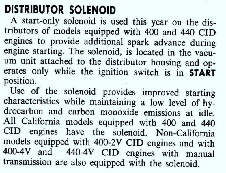

Trace the wire back to the bulkhead connector cavity, which one is it? There were no fork connections used on an original ’72 engine harness.
Got my answer from m&h! Thanks a ton to all for all the help!
This lead goes to the solenoid connection on the starter relay. The other end attaches to a carburetor solenoid. Note that there will also be the solenoid lead from the positive battery cable that continues from the solenoid connection on the starter relay down to the starter.
Found it as well, that would be a distributor advance solenoid, not a carburetor solenoid. Not all engines had them, California only likely. Strange M&H would include that lead as part of the harness, the ’72 engine harnesses I’ve bought from them in the past did not have it.
