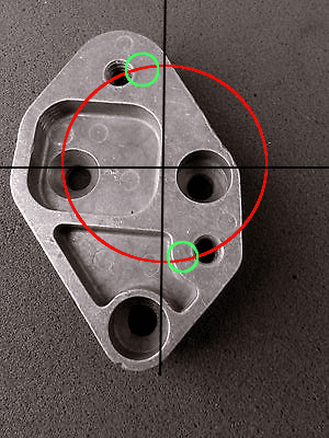

Make sure the adapter is correct (Kiwigtx post). For example, an abody adapter will cant the shifter a lot further forward at the top. BTW, The picture you provided appears to show it's not an abody adapter.

If the above is correct, just an idea to consider. YMMV with this......You might try moving one of the mount holes in the adapter a bit.
A little here would go a long way out at the end of a log handle. The top hole would be my choice in the adapter below.
Verify you'll still have enough threads on the linkage rods for the hole you move.
Or........make your own adapter.
