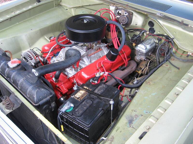

Here is my 68 273 with a Edelbrock Performer.

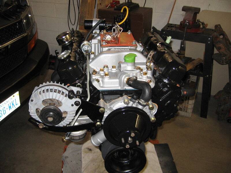

The brass plugs are what Toolman mike was talking about. This a 70 318 and I won't be using a heater. + the Edelbrock 2176 is non EGR but does have other water ports for emission applications.I blocked those too.

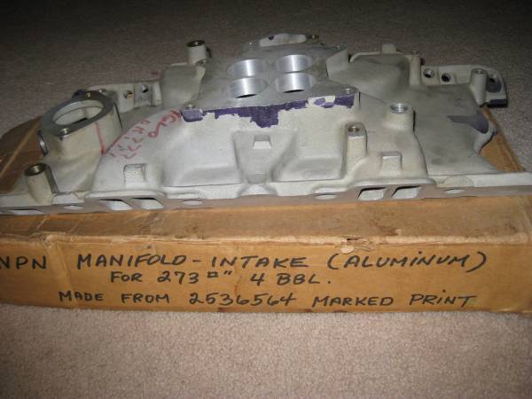

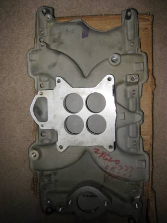

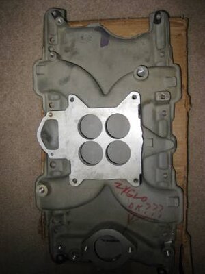

Interesting Bob. Removing the plenum dividers made a difference. Good to know. I have a aluminum 273-4 barrel manifold that was a prototype. It's a interesting piece.

View attachment 1173326 View attachment 1173327
WOW.....VERY INTERESTING PIECE....it looks as if you or a previous owner milled (?) the carb mounting flange flat or reduced the height slightly (Dychem Blue visable). When I removed the individual throttle bores of yhe cast iron manifold to accomodate the Carter AVS carb resulted in an open plenum. Your pix of the aluminum manifold looks basically the same, save for the individual throttle bores. When I removed the individual throttle bores was to accomodate the carb. An open plenum manifold usually results in better top end performance due to a more uniform mixture distribution via even mixture velocity, even though cylinders 5 & 7 almost share a common runner length. The old Edelbrock Torker II manifold looks to have been copied of your example....the only real difference is the port areas of the Edelbrock design were slightly different and had small dams in the port runners to insure relatively equal mixture velocity characteristics. I believe the only reason Chrysler used a single plane design was for a lower coverall height to accomodate a lower hood line of the Formula S car......just a supposition..... BTW, want to sell the manifold?.... it looks as if the manifold will only accomodate an AFB carb not a AVS, due to mounting differences.....

Yes, a interesting piece. Sorry, I'm not interested in selling it at this time.
