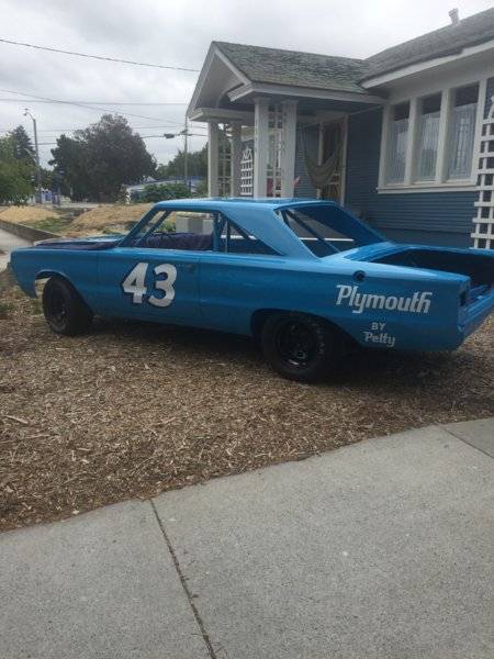

I've got a '67 Belvedere that had the same problem. I installed Mopar Performance Heavy Duty, ("Hemi") leaf springs. The right side springs have two extra half leafs so I bought two right side springs and put one on the left side. I went with KYB shocks. I am running 15x7 wheels with a 4 1/4" backspace and 225 70 15 tires front and rear. The car has a slight rake to it and there are no tire clearance issues. Hope this helps.

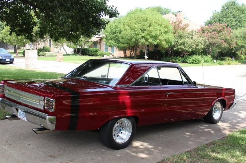

I put a set of Mopar Performance springs on my 66 Belvedere II. Part number is P4452983 and P4452982. You can get them from places such as Summit. Mine rides great and I have no clearance issues. I also run 235x60x15 tires on a 4 corners. Hope this helps.
'66 Belvedere with Dana 60 and Mopar HD hemi springs running Goodyear Bluestreak 8.00x15's with the 426 hemi and A833 installed.
