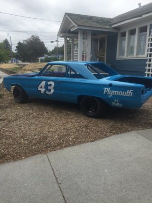

'66 Belvedere with Dana 60 and Mopar HD hemi springs running Goodyear Bluestreak 8.00x15's with the 426 hemi and A833 installed.
