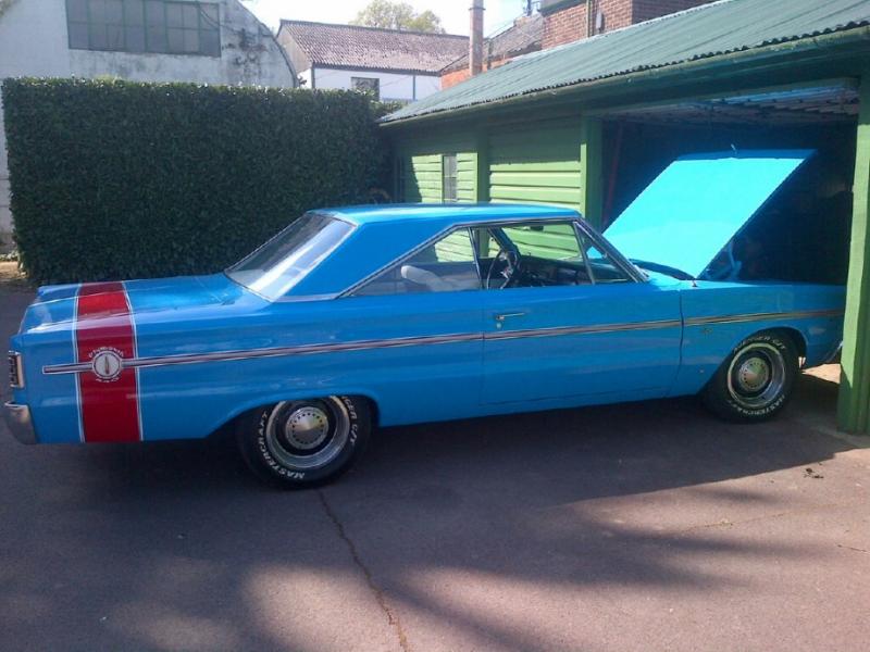

Here's a token picture, tight squeeze into the garage...
