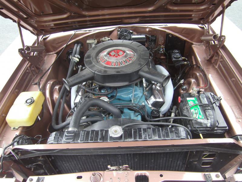

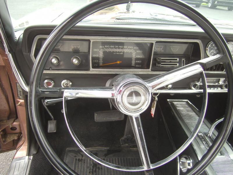

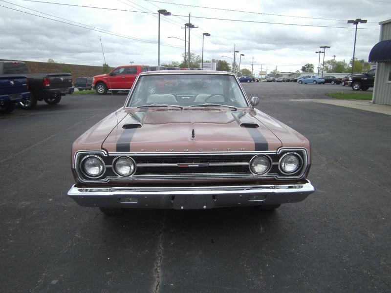

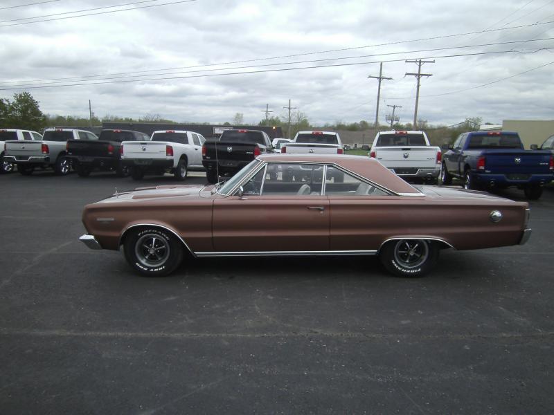

Ok B Body Lovers,
I found this GTX. It was restored in 2008 and supposedly numbers matching. The certicard is with the car but I do not believe the Build Sheet is. The car is located in the midwest so I would have to fly out and then ship back, so I am trying to figure out if it is worth the trip. The price I got out of them was $25,300. Any opinions or advice would be greatly appreciated!
Sean

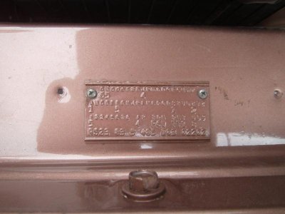

This is what I think I found out about the Fender Tag...
CAR: Plymouth GTX 2 Door Hardtop
ENGINE: 440cid 4-bbl HP V8
TRANSMISSION: 3-Speed Automatic
TIRES: 7.75 x 14 Red Streak Tires
MODEL YEAR: 1967
BUILD DATE: November 03.
AXLE: 3.23 Rear Axle Ratio
INTERIOR: Premium Trim Grade, Vinyl Bucket Seats. White on Black Interior.
PAINT: Medium Copper Metallic (Dodge, Plymouth).
OTHER: Black (Dodge, Plymouth), Formal Black (Chrysler, Imperial) Upper Door Frame Color.
MOLDINGS:
15: Unknown Option
ABC OPTIONS:
A1: 26in Radiator
E5: Unknown Option
R1: AM Radio
W2: Unknown Option
abc OPTIONS:
a6: Console
b5: Rear Arm Rest w/ Ashtray
j4: Moulding - Body Sill Narrow

Those pics look awesome, ask them more questions, like where it came from, history of the car, rock bottom price. This IMHO is a very nice GTX, price is pretty damn good too.
Keep us posted
Car looks good in the pics. Might be worth the trip to take a look. If you go take your coveralls and have a good look around and under at the usual places, floor and trunk pans, torsion bar mounts, cowl area, etc. Good luck.
