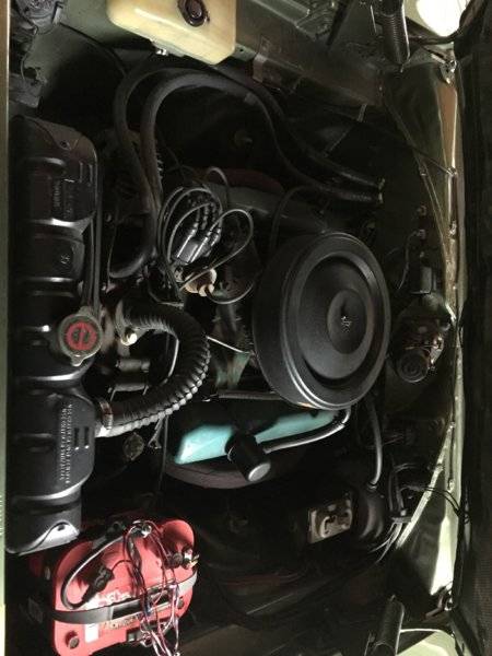

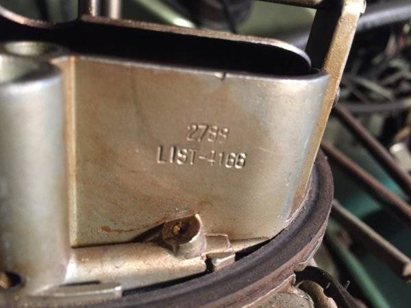

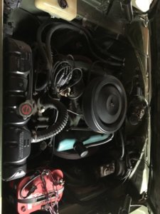

The car is a 383 and 727 auto... again, both original. The guy that restored the car did a few basic things mechanically to get the car reliable for my dad 10 years ago. The guy said he rebuilt the carb, but from what I can tell, it looks like he put a newer carb on it. It’s a Holley 4160 4-barrel, but I’ve seen mixed documentation saying all 383’s came with Carter carbs, and then some documentation that says a 383HP version came with a Holley. I can’t verify what the original carb was, but really want to know what motor we have. Here are some issues I’ve come across...
1) The unsilenced air cleaner is wrinkle finish black with no 383 decals on the lid of any kind. Shouldn’t it have a “383 4-barrel” decal on it?

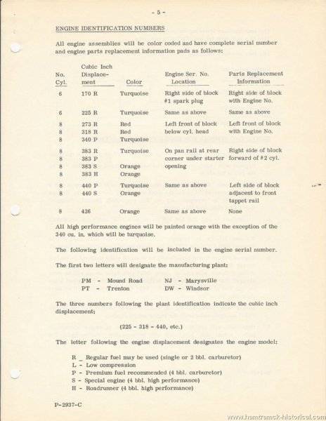

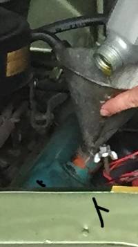

2) The motor is still the original turquoise, and never been out of the car or rebuilt, but the valve cover by the oil fill looks like it’s painted pretty sloppy with runs in the paint, and there is orange paint showing through under the oil cap where the turquoise has been scratched away by the oil cap. Why would it be orange? Could it be a Magnum in disguise?

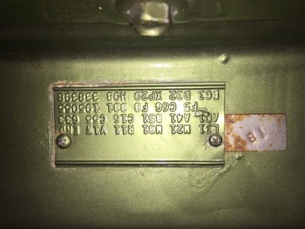

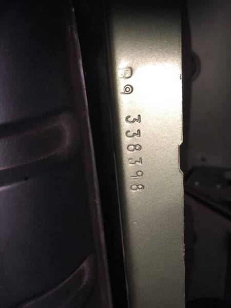

3) the fender tag has it listed as a 335HP 383, which I think is the Magnum or an HP version of some kind? This backs up my theory about a Magnum in disguise.
4) the fender tag has a second fender tag attached to it that no one seems to know what it’s for. Was this something the dealer ordered for the car that was custom or unique?

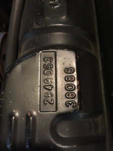

Here’s what I’m wondering... I’m thinking through my amateur sleuthing and minimal knowledge... maybe the “owners wife’s demo car” story was actually more like the “owners drag racing car” and maybe it was ordered with a 383 Magnum (orange) and it was painted and un-stickered to be more stealthy? I may be way off, so hoping you guys and gals can help us determine what we had here. He’s trying to get in there to get the casting numbers off the block to see if that helps.

And here’s a break down of the fender tag off another Mopar website:
XP29:
Dodge Charger
Premium
2 Door Sports Hardtop
H9B: 383 330HP OR 335HP 1-4BBL 8 CYL
1969
Dodge Main, Hamtramck, MI, USA
338398: Sequence number
E63: 383 cid 4 barrel V8 H.P. 335hp
D32: Heavy Duty Automatic Transmission
F5: Medium Green Metallic Exterior Color
C6G: Trim - Charger, Vinyl Bucket Seats, Green
F8: Dark Green Metallic Int. Door Frames
331: Build Date: March 31
195055: Order number
A01: Unknown Top Color
A41: 69 only White Hat Special w/vinyl roof
B51: Power Brakes
C16: Console w/Woodgrain Panel
C55: Bucket Seats
G33: LH Remote Racing Mirror
L31: Hood/Fender Mounted Turn Signals
M21: Roof drip rail moldings
M31: Belt Moldings
R11: Radio Solid State AM (2 Watts)
V1W: Unknown
END: End of Sales Codes

The holley is incorrect.....All BB came with a Carter focusing on 68-70 unless you had a six pack...
The small tag under the fender tag is an inspection tag

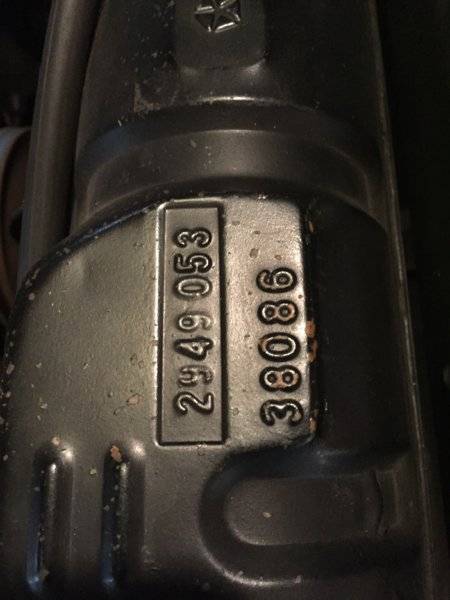

If it is a 383 magnum look at the flat pad by the alternator and if you see an HP stamped on it then there you go....To me it doesn't really matter what is important is if it is the original motor....Casting numbers do not answer this nor does the vin but the BS and the ID pad below the alternator will....
The blue to orange thing on early 69 builds is constantly debated....I always go on what the car tells me and further inspection will show what it may have been...

Thanks for the info and the welcome. I found a sheet on another forum that shows there was three 383’s available in 1969, the 2 barrel, the 4 barrel, and an HP model. Another quick web search claimed that the 2 and 4 barrel models had the Carter, but said the HP model had a Holley, which then would make sense. I’ll have him check the block. I’m in AZ, and he’s in Wis, so gettin it done may take a bit. He’s had the car since late-1969, so if there was any change on the motor, it would have happened at the dealership in it’s first 4-5 months. Been in our family in the same garage since so we know nothing has changed since then, besides potentially the carb during the restoration. I actually pulled the build sheet out of the car when I was like 17 (1987), and handed it to him to have it decoded, but haven’t seen it since... it’s in a file somewhere that we know he still has, but doesnt know exactly where it is.
Shouldn’t the air cleaner have a “383” sticker on it either way?

Welcome aboard- I can say that ur air cleaner is the same one my '68 Bee came with, no sticker.

Here’s a close up of the orange paint peeking through the turquoise on the valve cover.

Welcome. Find the numbers on the pad below the distributor and look down just above the oil pan on the side of the motor and give us those #s. They should clear up your paint questions...
