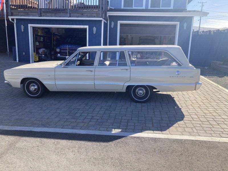

I have a 65 500 and a 67 wagon in my stable. The kids and mom dig the wagon.
