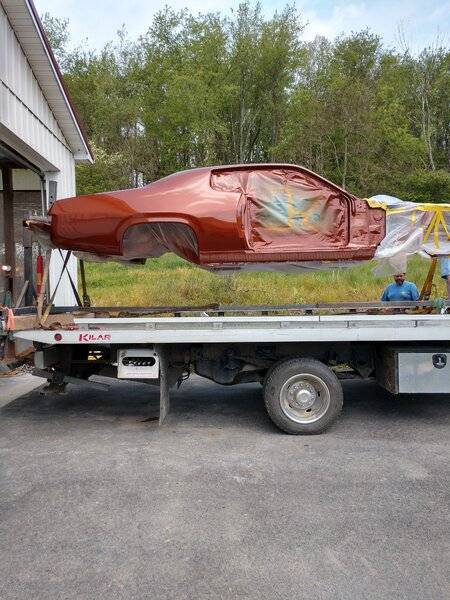

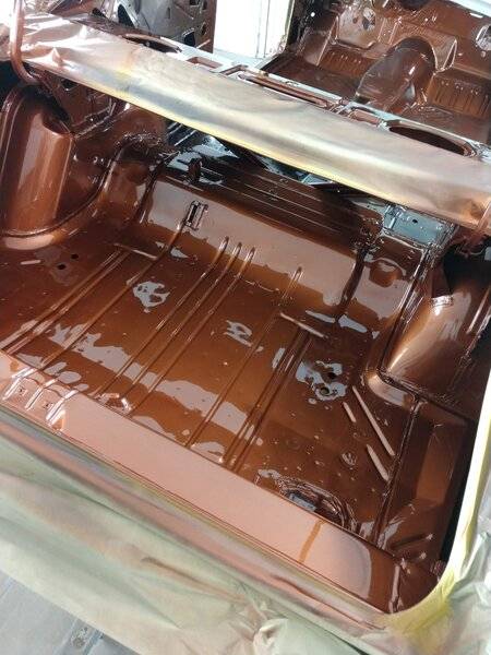

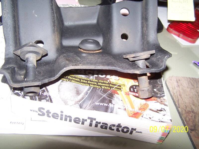

Thanks guys for letting me into the site.Im restoring my 73 roadrunner and need some info.This is my first Mopar.I need to know what bolt holds the cross shaft in upper control arm to the mount bracket on the frame.Mine got lost.pics would help also.Thanks I appreciate it.George.Here are some pics of car.

Welcome from Michigan. I went thru the same issue when redoing my car. Ended up buying all 3 kits before I got it right thanks to my neighbor.

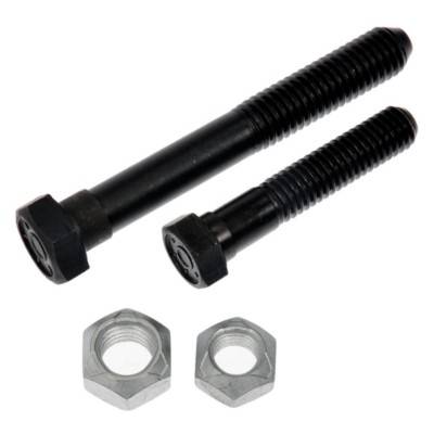

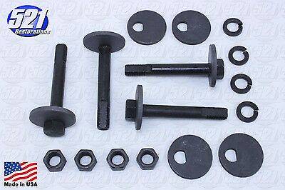

Do you need the upper control arm adjusting bolts....
the upper control arm Camber bolts....
or standard control arm bolts....

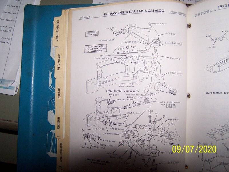

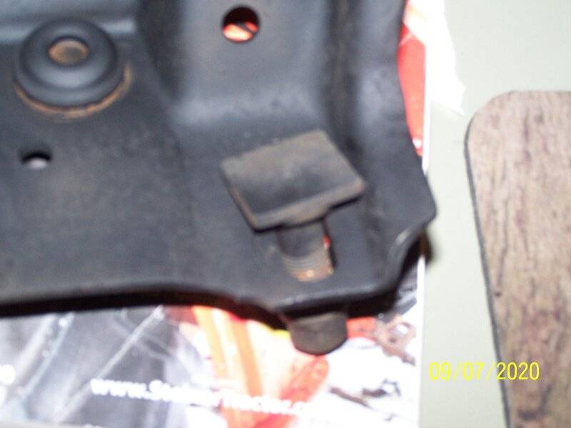

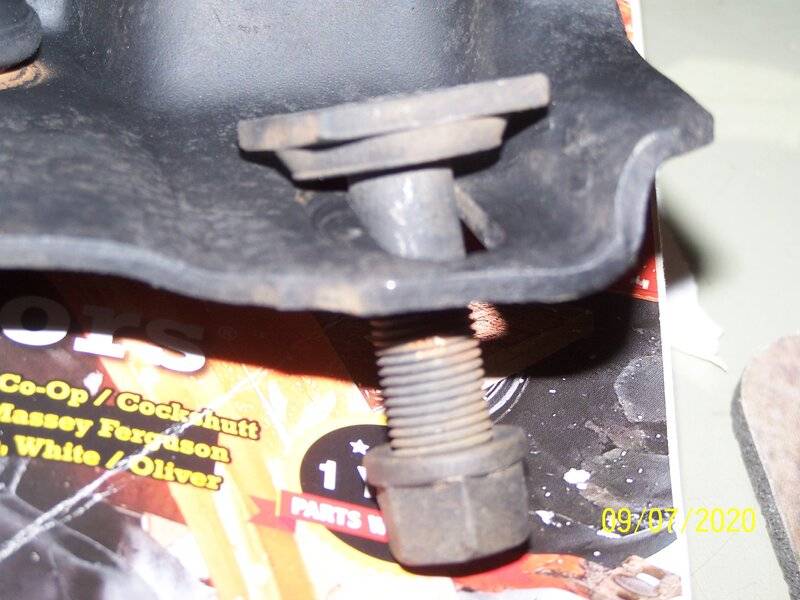

Bolt is #3402 650 and the nut is #6024 803. Let me check the garage as the upper control arm may still be in a tote and not in storage.
