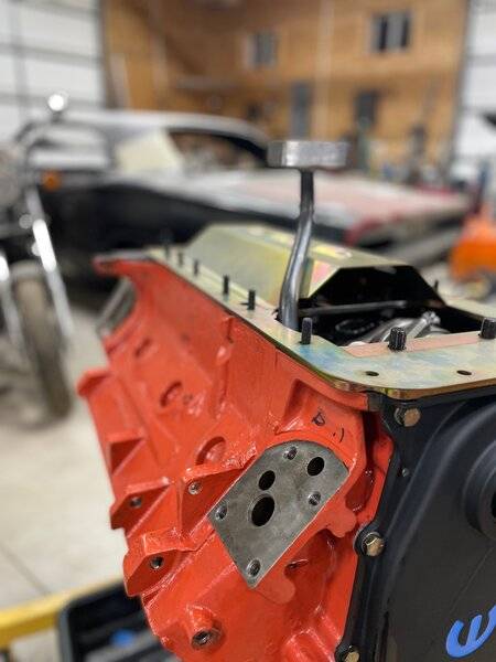

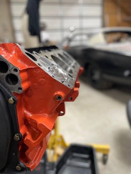

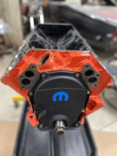

- 440 6pk => I spent some time with the 1's & 0's to come up with a respectable build. Targeted 700+ ft-lbs & 550+hp, Fuel Injection, solid bottom end dished pistons, potential for forced induction if needed and pump gas (89 targeted). See the pictures of this engine thus far.

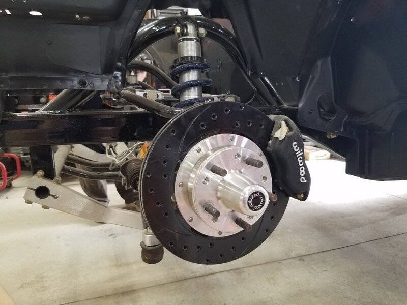

- Chassis was a no brainer, at least to my pops, Schwartz G-machine was ordered with power rack, SLA front suspension, 12" disc all around, Ford 9" 4-link w 3.73 gears
