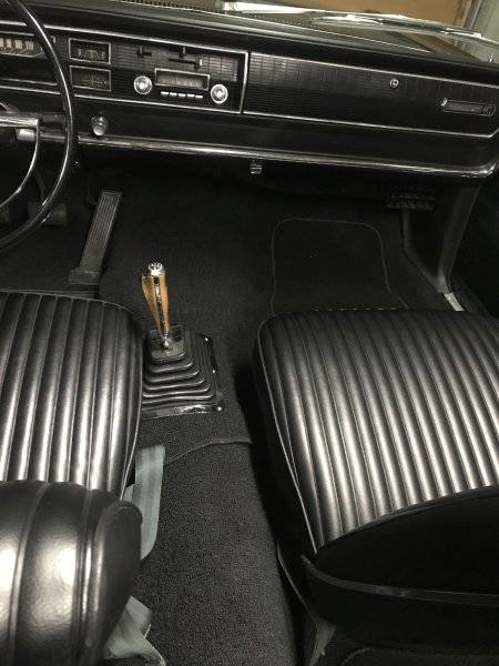

I recenctly purchased a 1967 Dodge Coronet 440 rag top with a 383 4 speed. This was originally a 318 4 speed. So, can anyone tell me which console would fit on my car? The shifter comes out of the tunnel further back then the original location.

Welcome. The shifter shouldn't be further back unless someone installled a non b body transmission. Got any pics?

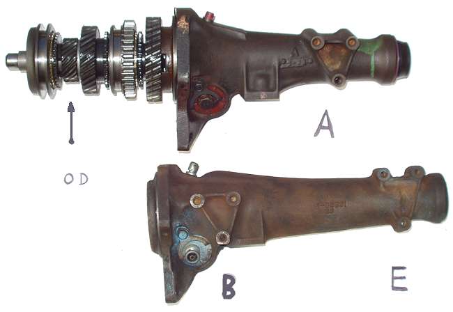

This link shows the console. There's a difference between the 4 speed and auto consoles.

you could always change the tail housing to a correct b-body style
it may even have 2 different shifter mounts too
depending on what year & model of trans
so you can use a B-body console

I"m guessing someone installed an a body transmission? There won't be a console that will work in that case. You'll need a b body tunnel hump (if not there already), b body transmission, 4 speed console, a 4 speed shift handle (different than non console), 4 speed console brackets. I would figure out what transmission you already have though first.

Get under your car and see what you've got compared to the tail housings shown in post #6 - should also record casting numbers/codes and take some pics for futher reference.
