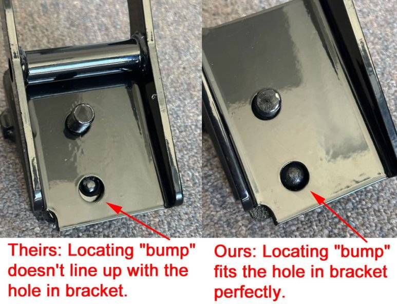

I was wondering if any of you have had this issue with new motor mounts. Purchased a new set of rubber mounts and the little bulge part does not line up with the hole in the bracket. With that said, should the mounts be returned or have any of you just elongated the hole?

The new mounts I purchased from a vendor at Carlisle turn out to be Westar part #EM-2250 and I found the locating dimple to be about 1/4" shifted out of position towards the mounting bolt.

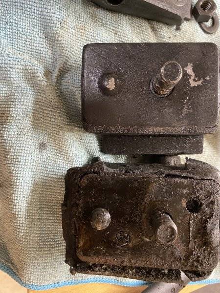

I'll need to take my original bracket to Napa and Carquest to compare to parts they have - but glad to know others have run into this same issue. Posting a few photos to illustrate the issue for anyone else doing this repair.
New mount (top of photo) compared to old mount:
Old mount has an est. 1-1/2" center to center distance
New mount has an est. 1-1/4" center to center distance

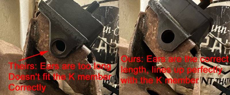

For those interested, we are coming out with new mounts soon that will fix all these issues. (Should have them in stock in about 4-6 weeks) The new part number will be "2250HEAVY" and they will likely be $29.95 each. Here are some of the differences:

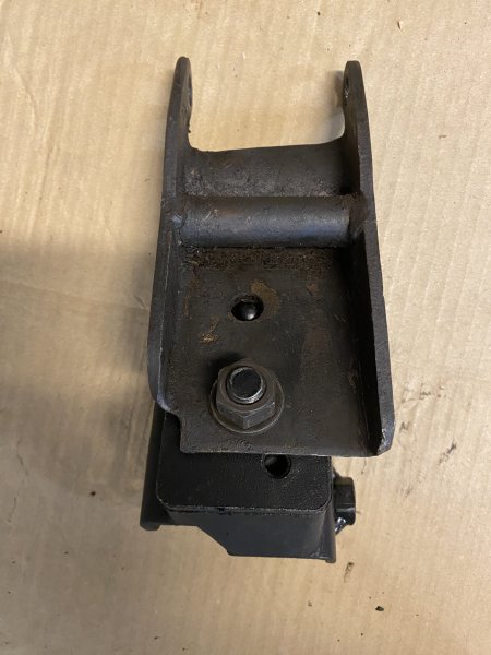

To continue the thread on my experience I will say the NAPA part fit well (photo below) and dimensions were similar to the original as far as I could tell.
For anyone else looking the NAPA Part# is 602-1118.

Reviving old thread with a thank you to 440source. I ordered a set of their brackets and mounts from their EBAY store. The parts arrived and the rubber mounts were a set of the crappy ones that dont fit right. I messaged them to figure out what the problem was, to find out that they sell the crappy ones too if you want the el cheapo version. I explained that I just saw the name 440source and assumed I was getting the right ones.
They sent me a set of the 2250heavy mounts and said keep the other ones too. BIG DIFFERENCE the new mounts fit perfectly and are much better made. THANK YOU 440SOURCE for going above and beyond and sorry I am so easily confused, I am just an old flying squirrel.

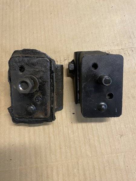

I have some excellent originals that I had up for sale here but got flack because they are gonna be all cracked up and dried out so I no longer offer them for sale here. Kim
Are they cracked up? If that is true, why are the ones in our original Charger still looking good? I think things depend on how where they were stored.
