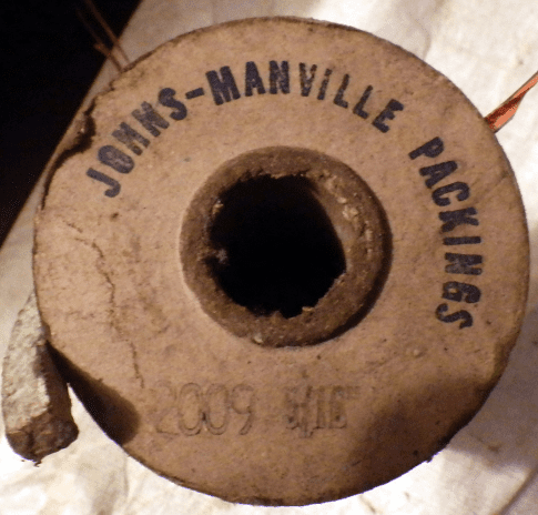

Don't lose sleep over small leaks, here's what I use;
