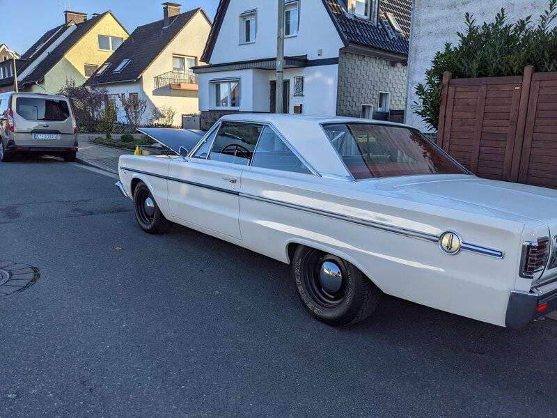

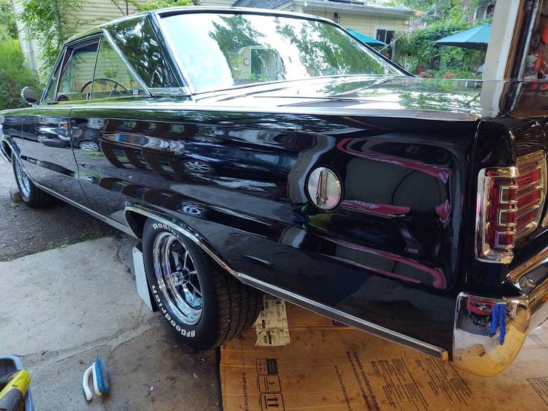

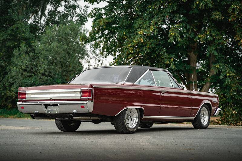

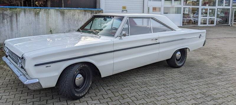

I also like the 21 series from US wheels gut never see any mopar (not only b Bodys) with this wheel Design. And yeah, I don't want to be the first and after mounting I dont Like it on the Car :D Here are one Picture of my Car and one from a user from fbbo with the Torque thrust
Torque thrust D look great on any car! I prefer the gray, but polished look great too.
I also prefer the Grey on a White car. The polish is also nice but from my point of View more for colors like Red, blue, green. Etc

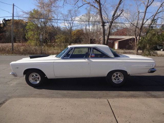

This is the only photo I could find quickly of the Weld Stars on a similar car - I know its a 65, but maybe it will give you an idea...

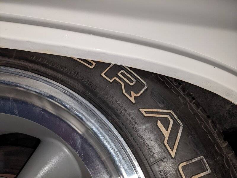

Buuut, the tire grinds during driving trough Corners
Arrgh...
Tires are Same as before
255/60
Before 7" with 4.125 BS, now 8" with 4.5 BS . Calculator Said 3mm more to the Outside as before. Any Idea??

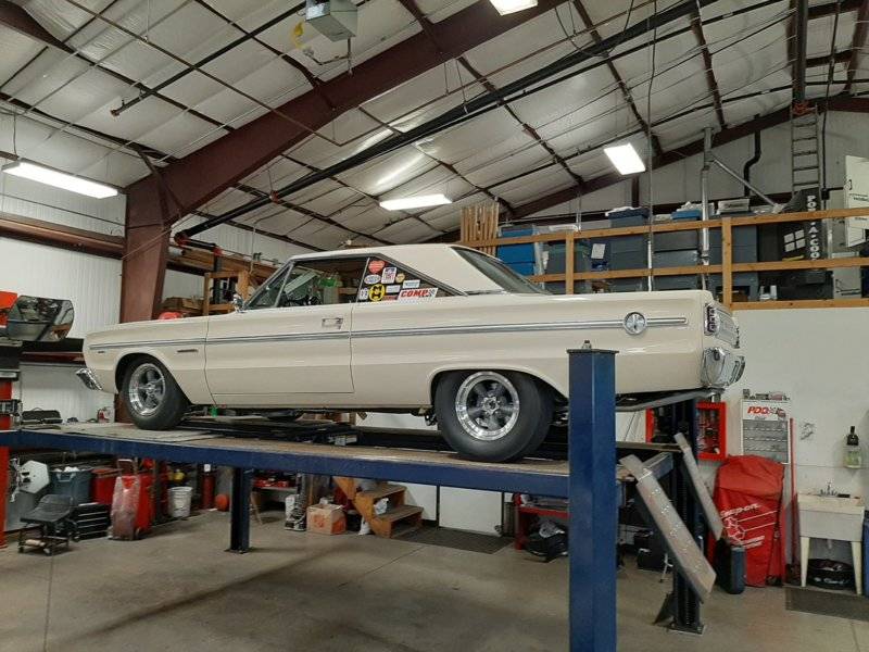

Try 70 series tires. They are taller and narrower, size for size. I have 1967 R/T with same space limitations in the wheel wells. I finally put a rear sway bar in to limit body movement during driving and cornering. I used the frame-hung style, rather than the one that mounts to rear end.
I have a 245/60 -15 on a 15"X8" with 4.5" backspace, probably the largest tire I would be able to fit.
