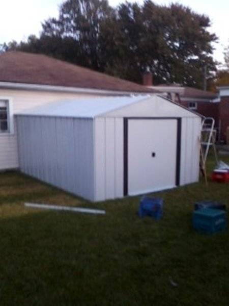

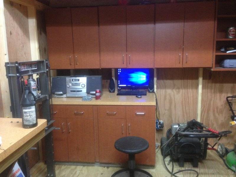

It has been a couple of winters since my daily driver has been garaged, while the RT was being put together. What a PITA it is scraping ice and snow off a car in freezing weather.

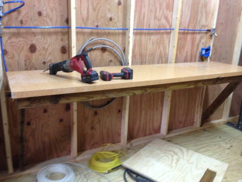

I decided to put the shed next to the garage so I could put my compressor in it. That is a twofold improvement-more space and less noise in the garage. I drilled holes in the side of the garage and the shed to run electricity and air line. I am also going to put in lights and outlets. No need to dig a trench to bury an electric line.
I put one of those sheds together what a pain in the ***. I bought myself a shed it was real easy to watch the guy set it up. lol
Then later added cabinets and a work table, Air lines and power. I ran an airline out of the shed underground into the garage so I don't have to hear that compressor.

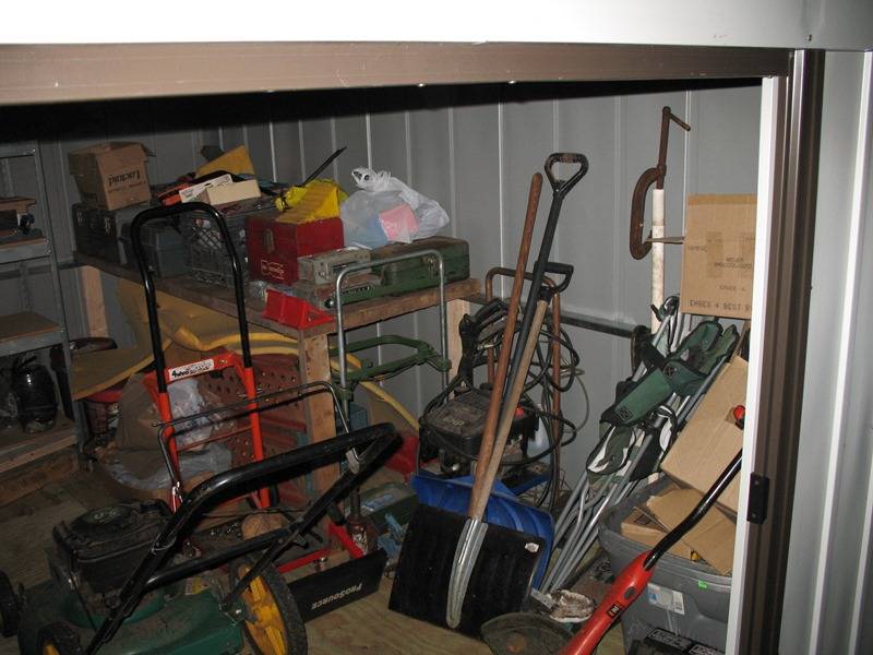

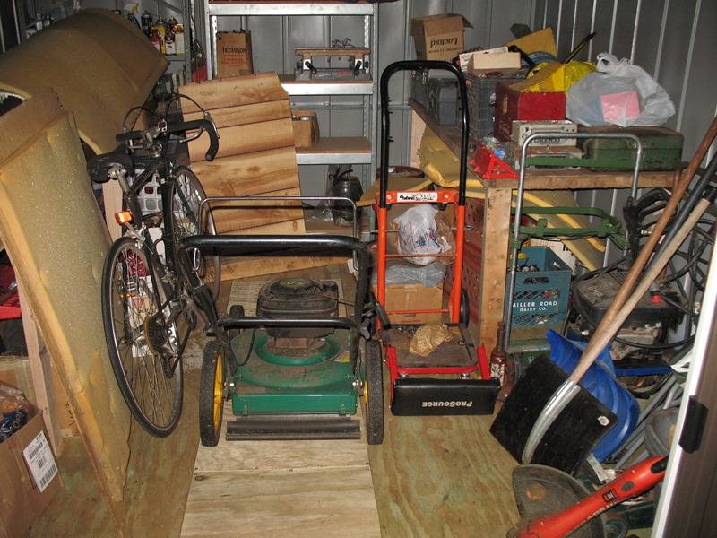

I ran an electric line for an outlet and lighting. Installed one two tube fluorescent fixture. I ran another line for the compressor. I hooked that one into a wall switch with an indicator light I already had been using for the compressor. That makes it nice to be able to turn it on and off from the garage. I replumbed the air line. I have a female coupler in the back of the garage and one at the front.
WOW, what a difference in the noise level in the garage when the compressor is running!

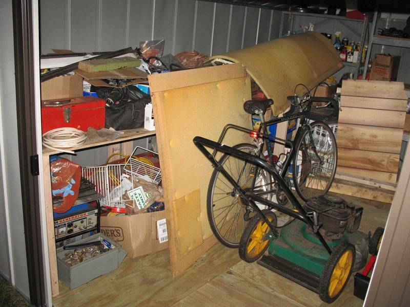

In the first and third pics of the inside of the shed you can see a shelf I made from a door in the rear right corner. The compressor is in that corner. Just as I had done in the garage, I am going to wall it off, and sound insulate it with foam rubber. Hopefully that will keep the noise level down to a quiet roar for the neighbors.
Even if I don't get anything more done before the weather becomes completely uncooperative I am ready to be able to store the RT till spring.
