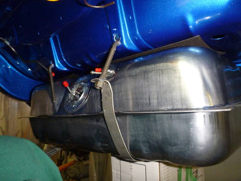

Do I really have to "cave in" the seams on the front and back of the tank so the straps actually get close to the "J" bolts?

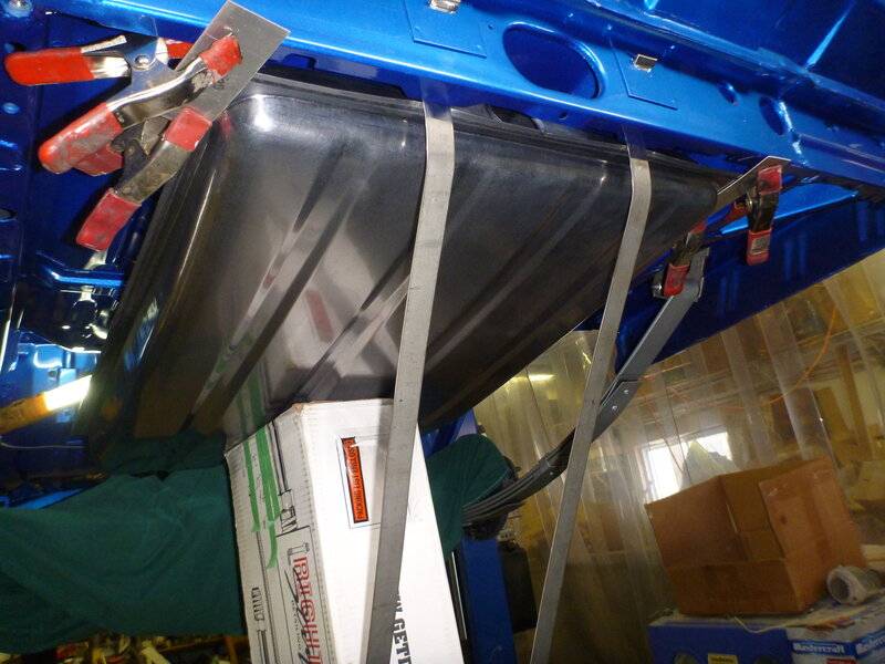

No... not any more than it should have come from the manufacturer anyhow, with just enough bent to locate the straps.

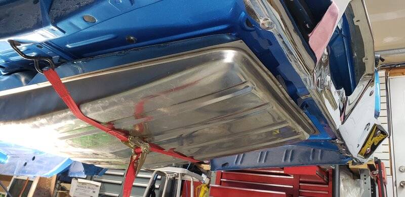

Yeah, my stock bolts and stock straps. I'll try again tomorrow! Just figured I'd ask before getting the floor jack and
the sledge hammer out! I have the tank held up with a ratchet strap going across the bottom side to side to the
holes in the frame rail. The 1/8" rubber pad is brand new also. Thanks Guys!
No, bumper removal is not needed. Yes, slight tweaking of tank flanges may be needed.

Yeah, I got it! Thanks DadsBee for the pic's. I did have to use the floor jack and a 5lb. BFH
to get it sasheyed around to get the nuts started with the help of alot of swear words! I wiped
the darned thing off with WD-40 and now I need sunglasses to look at it. I'm not building a
show car, but hey Dat Ting looks Nice!
