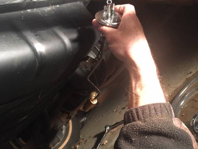

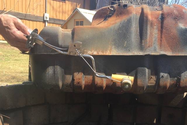

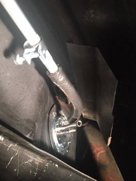

Adding some photos. This is how I have it installed, and what it looks like outside the tank.

That doesn't look like it's near the bottom of tank. When put it in the tank can you tilt it down and touch the bottom of tank? Can hold it on side of tank like it was in the tank and eyeball it?
Oh.. good idea
Actually i still have the old tank i can get a better photo on
there is a bend about a quarter way down the line that i suppose i could adjust to get it lower?
Or, just keep adding gas
Shadow cuts bottom out but see bend in tank. I tweek the bend closest to sock until sock touches bottom of tank. You don't want any metal of sending hit bottom of tank though. Use to run my 68 Dart low on gas often. The point of hook that holds the float put a hole in tank. Of course it was when I had 2/3 full tank.
In post #13 top pic-- is that your fuel line connected to the sender? What is the diameter of the other fitting that doesn't have a hose connected? Are you using 3/8 fuel line?
in that pic, the line isn't connected but yes.. i believe the line is 3/8.
Looking at the sender on the website I do see it says 5/16"
