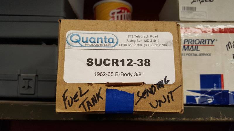

Supposedly these are supposed to read in the correct ohm range now.
1963-76 Dodge Dart Fuel Sending Unit

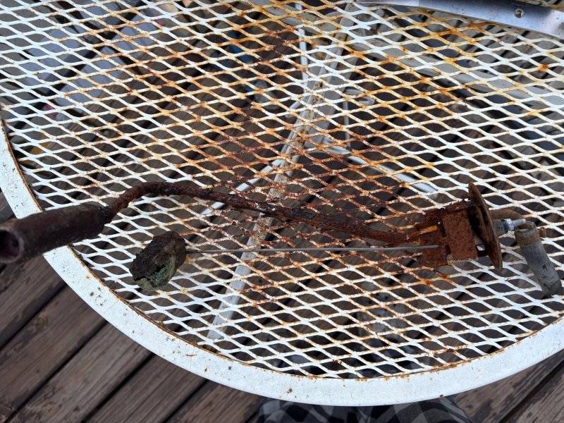

Do you know where I can get the float and screen if I rebuild this sender?
Is something wrong with your old sender?
It's all rusted. Can it be cleaned a fixed?
Should be able to recondition it. I don't know who can recondition it, Instrument Specialties stopped doing them. Unless I read wrong. They could possibly refer you.
