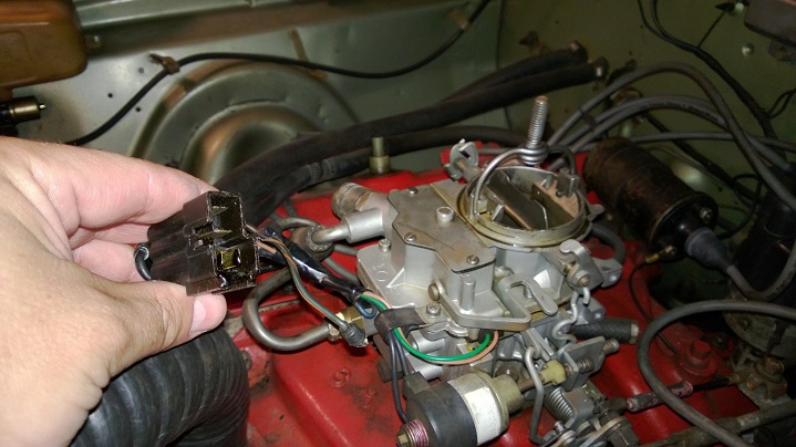

Figured I'd see what kind of carb I got with the 318, and I must say I'm a bit mystified... as I understand it, the original carb is replaced and while it looks a bit like a 2-bbl Holley 2280, there are some differences. Would be nice to know where the carb comes from originally.
Also, what's this wiring hanging from the carb? It's not connected to anything...

One pair of pins looks like they go to a fast idle solenoid.
The other wires go into the float bowl area.
This is just a wild guess, but it may be some type of “leaning” circuit for better fuel economy.
I really have no idea other than that.
I realize you are in Sweden and may have limited options, but I would suggest going to a different carburetor if possible.
I don’t like the looks of that 2-barrel. I think it is some type of non-Chrysler one.

It looks to be a feedback carb off an 80's car. Junk it and if you do not want a 4 barrel you should look into a stromberg 2 barrel. That's what replaced my old carter bbd.

It does resemble a Holley replacement carb. The wires are most likely for that idle solenoid and possibly a bowl vent solenoid. If it runs well as is let it go, but if not then get an old BBD or a different version of that Holley.

Thanks guys. I figured it might be a carb from something newer. The thing works, but those wires sticking out going nowhere look kinda annoying... might begin with taking a pair of cutters to them.

the throttle lever springs look like an AMC / Jeep carb BBD. check the tag number.
Thats a feedback carb used with Leanburn on the Mopars in the late 70's thru the 80's. I believe that carb uses a solenoid insde that controls an air bleed to control the mixture which was controlled by a controller. You dont want that carb. Ron
