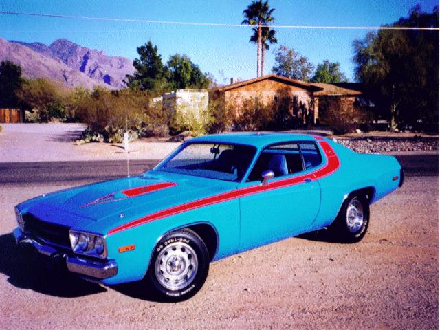

Well, I have been checking out this site for a months now and have read many of the posts. A lot of great people with a huge amount of Mopar knowledge with the same interests as mine (B Body Mopars) I'm happy to join. At the present time I own (5) Mopars.
My pride and joy is my 73 Roadrunner GTX with a 426 Hemi (Petty Blue). I'm the 2nd owner of this car. I purchased this car from Las Vegas Dodge back in 1976 while I was going to college. The car was my daily driver for over (6) years until I was out of college and had the money to start a restoration on the car. I installed the 426 Hemi and Dana 60 rear end during the two year restoration. I have completed most of the work myself. I love the Hemi and I like the fact that I built a car that is unique. My only regret is I should have kept the original 440 that came with the car.
Now that it has been (27) years since the restoration, it’s time for a refresh. But the car still holds it’s own at local shows.

Welcome! Your car looks awesome, especially considering that it has a 27 year old restoration.

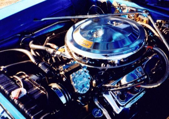

Welcome !!I like that you retained the A/C on the hemi,cool:bootyshake:
welcome.i don't think i've seen too many other people put a 426 into that body style.was it a tight fit?nice car,i had a 74 RR that was blue w/black stripe.
To get the Hemi into the engine bay without interference with the power brake unit and allow valve cover removal, I had to move the engine forward 1 1/2 inches. Which meant I had to make a custom oil pan, motor mounts and notch the K-member. One of the hardest challenges was to get the factory A/C to fit with the large Hemi air cleaner. Some new brackets were fabricated and some original ones were modified.
My goal when I installed the Hemi was to retain every option that came with this car from the factory (Power Brakes, Power Steering and Air Conditioning). I wanted it to look 100% factory stock. Just the way Mother Mopar would/should have done it.

Of course hindsight is 20/20 but if you would have used an offset brake booster set up as the factory did with the 71s with the Hemi and power brakes you would have saved yourself a lot of work. Also, there is now a special A/C compressor bracket made that mounts/hides it under slung for six packs and Hemis.

My comments were mainly pointed at you hard work regarding making the engine movement that if someone would have helped you that knew something about these cars when new would have been able to let you know that the factory parts were produced to fit that Hemi in your 71 up B body with power brakes without moving the engine.
