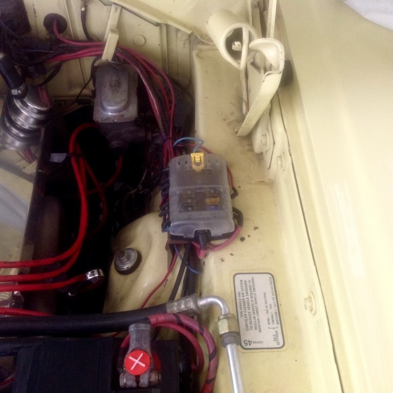

69 Coronet. Ramped up to help power windows, ac, garmin, dash cam, Valentine1 etc. West Marine sourced.
I pulled a block from a wrecked Police Interceptor and am planning on mounting it in about the same place seen above. I'm too damn old to be crawling around under the dash to replace fuses. :)

View attachment 356810 69 Coronet. Ramped up to help power windows, ac, garmin, dash cam, Valentine1 etc. West Marine sourced.
I have an Ez Wire mini and that's where I'm mounting mine...
Like Bru said to dam old to be crawling under a dash, especially with a cage..
As far as heat goes, that's predominantly where they are in new cars... Can't be too bad I guess...
Inside the engine bay... any concerns about water or heat???
West Marine stuff is supposed to be pretty good for weather concerns. Been there for 10 years, no problems. Make sure that the hood hinge clears when closing and does not crush the box. Position carefully.
Another great idea! I'll have to see if I can track down an empty box to put my fuse block in. Thanks!
