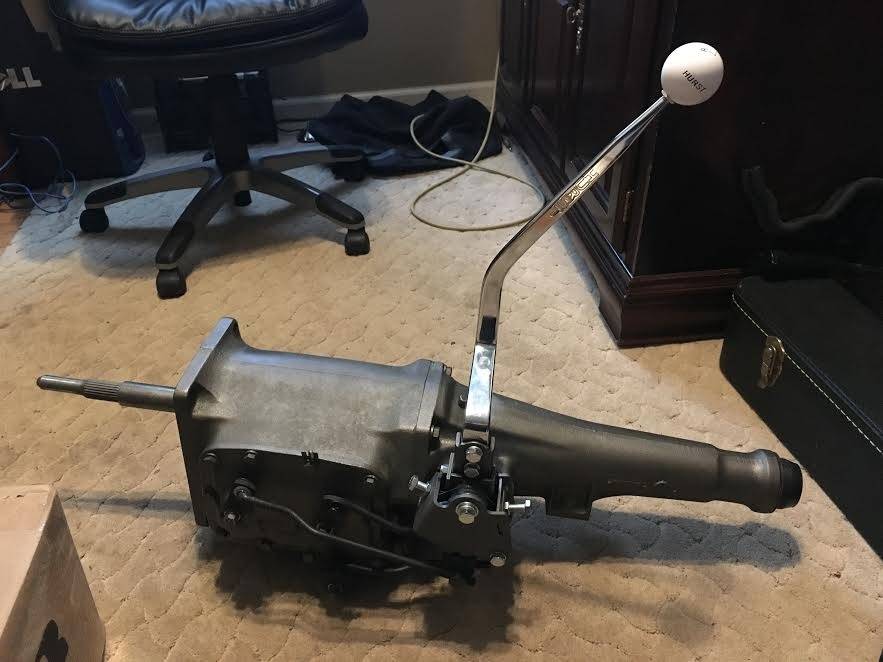

A friend had a low mileage RV engine we're freshening up with a pair of re-worked 69 440 Magnum heads, new oil pan and pickup. It'll be a low compression for a couple years, but it should be enough for the time being and budget.
onlyone,
Thanks for the double-checkSo, I'm guessing you have a forged crank in this engine and it is drilled/reamed for a pilot bushing?
Good.
Good.
It's a cast crank (1975) but measured out perfectly for the O.D. of the needle bearing pilot bushing (O'Reilly p/n FC69907). Will depth be a concern?
