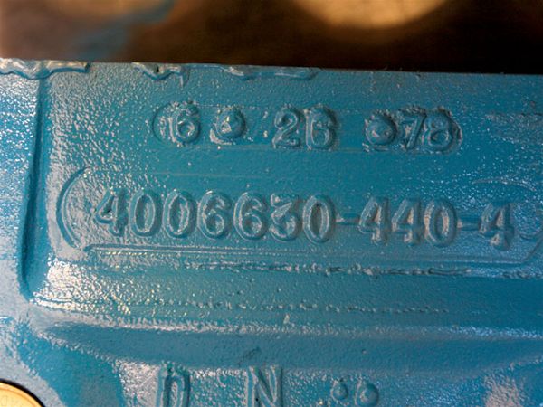

it will look something like this

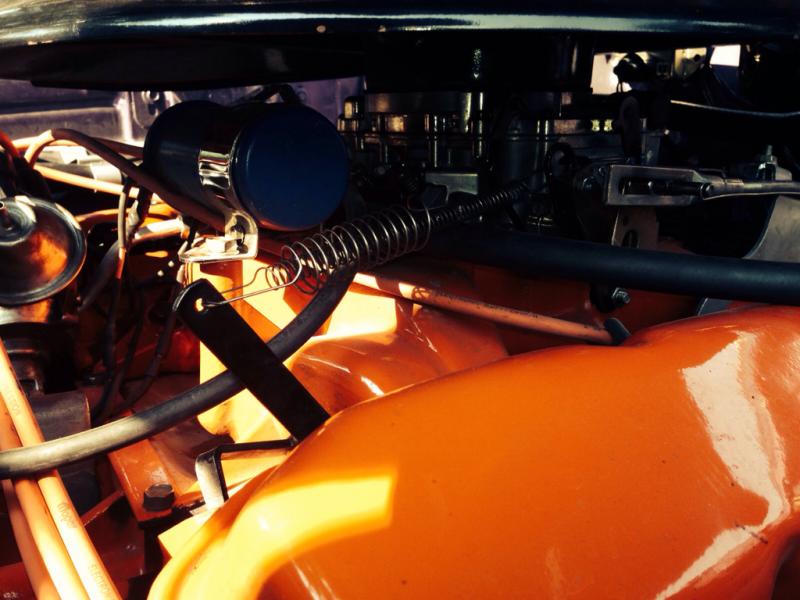

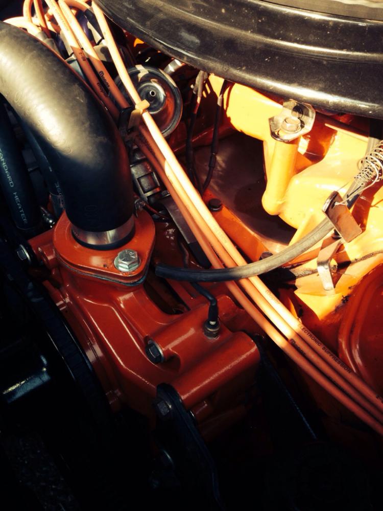

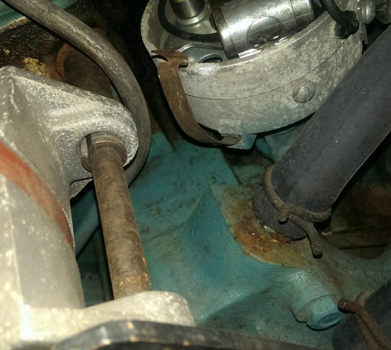

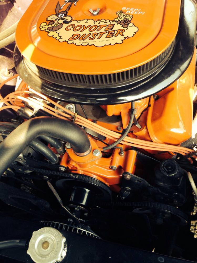

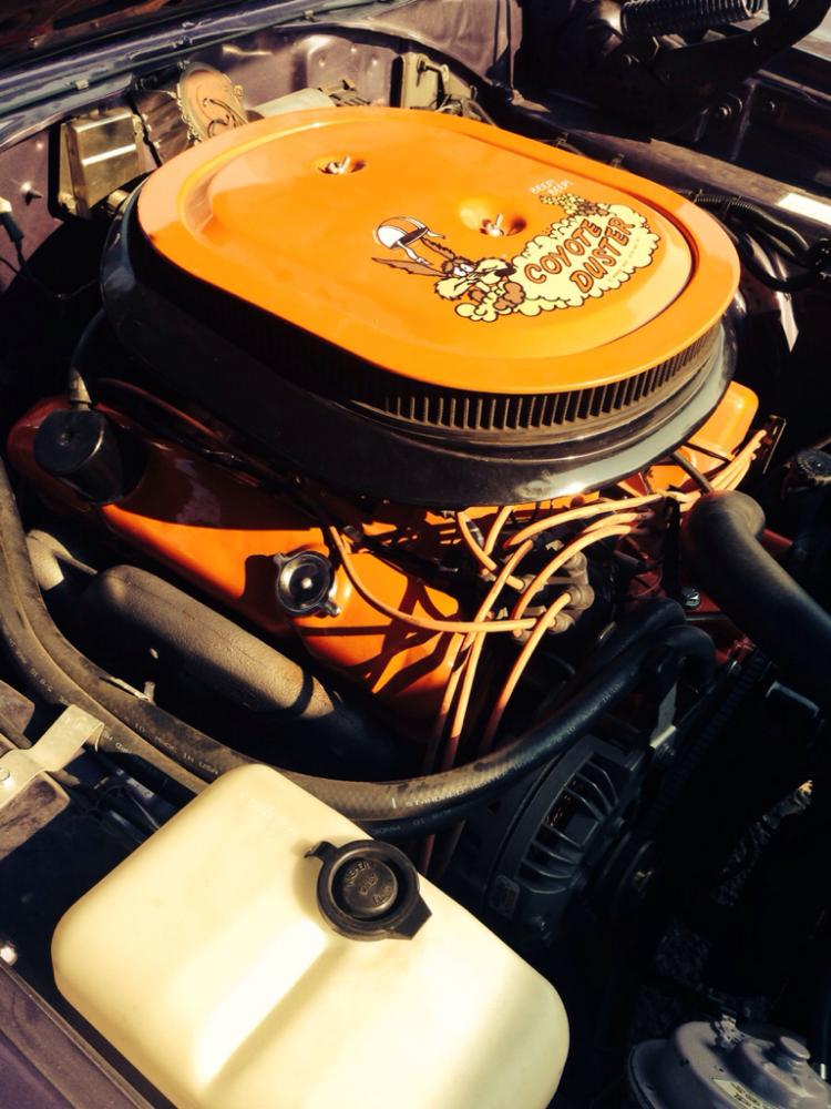

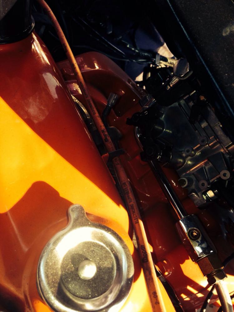

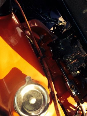

I agree. It runs well. Just want to know what I have. The dealer told me what he knew for sure, but I'd like the real story, as much as I can find anyway. Here are some pics of it if that helps. I'll see if I can find those other numbers. Not sure where to look.

You may not be able to get a good picture.... take a crayon and a piece of paper and feel around for the numbers like in the above photo find the freeze plug and try to get a rubbing of it and then post it... the picture above is a 440- 4 bbl once you get in there it's tight from under the car.
the pic I posted , and it is in the same place as my 440 (I just went out and looked) is at the rear of the block on the passenger side below the head. there are also casting numbers on the drivers side. but the passenger side has the date code. because the 400 replaced the 383 , there is a good chance we can narrow it down just by the date
The first picture shows the distr. hold down bracket against a small tab. So I'm saying 383 or 400 cu. in.

Looks like a "b" block to me. (383, 400) A "rb" raised block, (413, 440) would have a ID pad on the top front of the block. Just under that disconnected vacume hose in the picture.
Look under your distributor, on the block to find the ID pad on a "b" block.

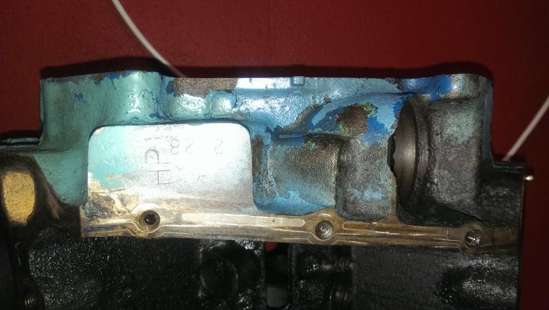

The statement was made that maybe yours was ground off but you could look there to see. It's a flat pad favoring the outwards side of the block under the distributor.
Top pic is a "b" block. Bottom is a "rb"

I think I see the numbers 1X Stamped back in there but to be totally honest I can't really be sure where I'm looking.

First of all...Hi Toast_Eater, welcome! Always nice to see someone new here. You might want to go to the welcome forum and introduce yourself. Show us a picture of that tribute!

If you look closely at the flat spot under the distributor in my pic, you'll see a "HP" stamping. That's where you should find your numbers. You can remove the paint to see them better.
Now if you have a "RB" engine, the flat pad will be on the top/front at the valley pan mount. In your picture, there is a disconnected vacume hose and plug wires covering this area. I don't seem to see a pad there but I could be wrong.
Now the casting numbers are located in the locations that were stated by WP29440SE. They are raised numbers in the casting on both sides of the block.

So, from the numbers you have provided stamped into the flat pad just above the oil pan, you have a 1966 model year engine, the 6 from 6A164793. The vehicle it came from was assembled at the Lynch Road plant (the A). And 164793 is the serial number of the car. The pictures you have provided show that it is a B engine. In 1966 there were two B engines, a 361 and a 383. You will have one of two numbers cast into the side of the block, 2205712 for the 361 or 2468130 for the 383. See what you can find and get back to us.
...you have a 1966 model year engine, the 6 from 6A164793. The vehicle it came from was assembled at the Lynch Road plant (the A). And 164793 is the serial number of the car. The pictures you have provided show that it is a B engine....
Which would be a good answer IF they stamped VIN numbers on a 66 block. Since they did not, we know this is a 76 model year block. The pictures indicate a B series engine meaning it is a 400 not a 383. Since it came from the Lynch Road plant, we know it was some sort of B body like a Coronet or Fury.
I'm guessing you will find 6T400 plus, probably, the letter "E" (cast crank) stamped on the pad if the numbers haven't been ground off.
