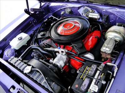

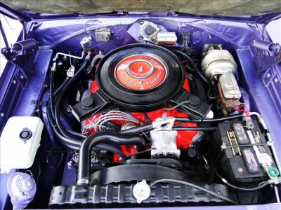

Here's a couple pics that might help.... "looks" like the one I put in mine (Saginaw). I'm not sure about this A/C compressor though. This is a 70 Roadrunner 383 A/C car

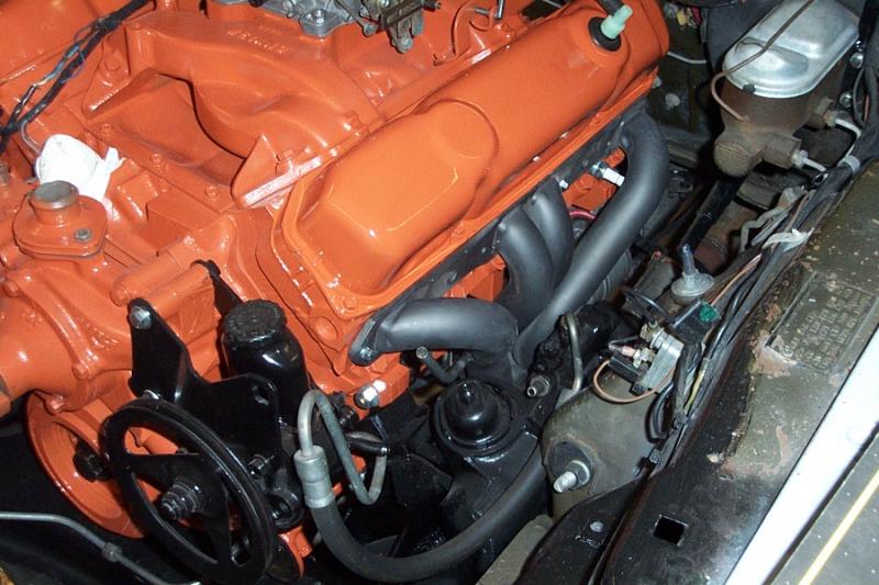

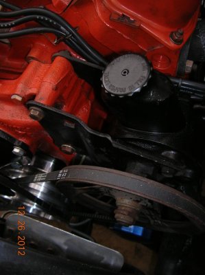

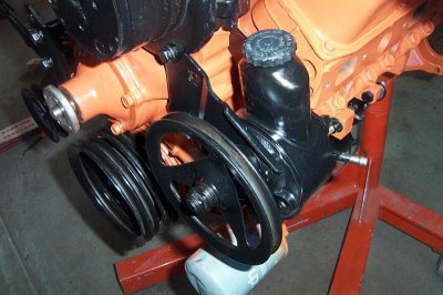

I e-mailed you some pics but will post some here too.
With and without A/C.

Thanks, a photo is worth a thousand words.........at least to us slow typers.....LOL

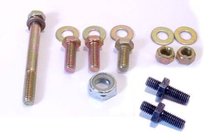

everything is sort making sense now.....one other question.....the bolt kits for the ps pump has a couple bolts with threads at each end....what are those for?
thanks again
