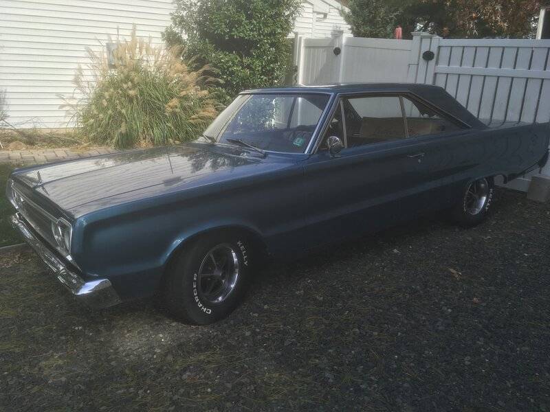

Found the site when the passenger door on my 67 Belvedere wouldn't close, then wouldn't open yesterday after going for coffee with my handicap brother who had to crawl out the driver's side.
Found some great advice and insight...
Got the door open last night, the second tooth is not catching... now need to figure out what to do to fix this. Never had issue with the door before but now I'm thinking I need to adjust the striker.
Any and all advice will be appreciated!

Very pedestrian Belvedere, just the way I like it.
Still has drums all around (they work great).
Came with a tired and smoky 273 bolted to a 904A auto.
Slight Rebuilt on the 904A but couldn't save the 273 so I dropped a slightly used (32k miles) 318, a new 2bbl carb, new rear springs and shocks all around and new headliner... and there she is. I have a couple other classic muscle cars but LOVE driving this around just the way it is!

Welcome aboard! Beautiful car. You get 10 points for posting a pic, LOL!
Lets see some more pic's but also include the door area so we can help with your issue.
