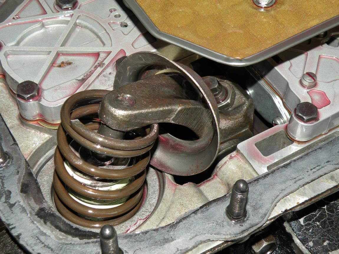

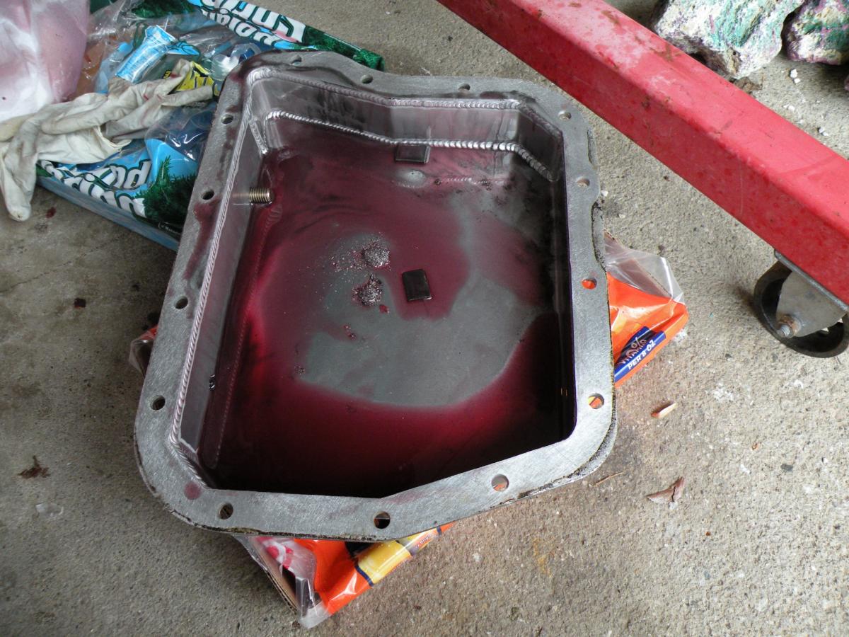

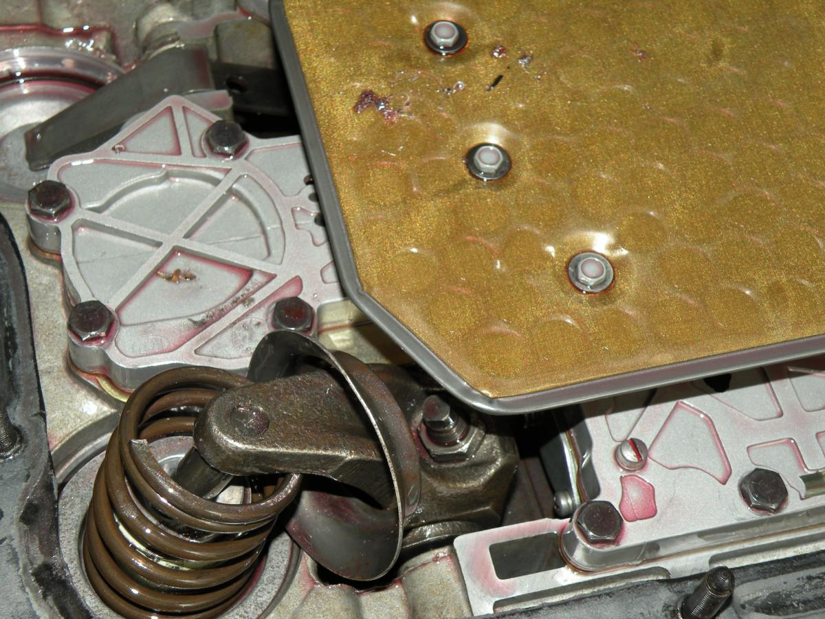

it's not the rear servo. if it was the rear servo seal, you wouldn't have reverse but all forward gears. I'm betting the clutches or band. ask me how i know?

1st is engaged by the rear clutch, the rear servo (55psi, which means the rear band is applied). reverse is engaged by the front clutch and the rear servo (230-260psi, which means the rear band is applied). there is a huge difference in pressure on the rear servo.. if there is a light leak in the seal or the band is not adjusted properly, 1st gear may not work and it will slip BUT reverse may still engage due to the 4-5x higher pressure being applied to the rear band. reverse may not be 100% engaged due to the band adjustment or bad seal, but it could still be effective enough to put it in gear, whereas first would not be applied at all. the reverse band MUST be applied in order to have first and reverse gear.
not saying you are wrong superstockracer, just saying that your problem (from the pics) shows a bad rear servo snap ring or broken rear band (which is extremely rare in and of itself). just a question, but did the rear servo lever strut get installed sideways or longwise? if it was put in sideways, it would cause entirely too much movement of the rear servo lever causing the servo piston to top out and the strut to fall away leading to rear snap ring failure and the ballooning of your spring retainer.
