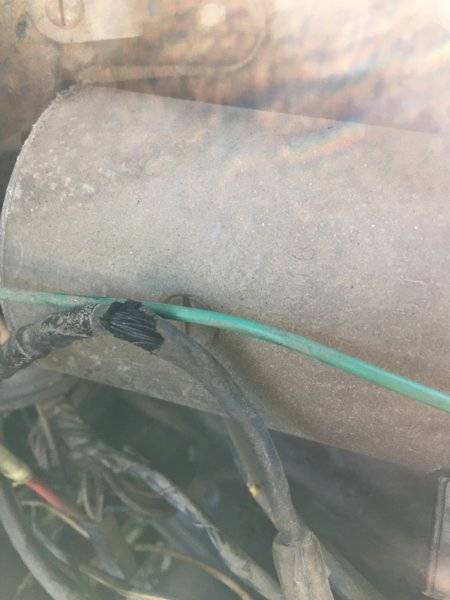

I think I found the problem. Fusible Link that comes off of the starter relay.
I fixed the fusible link. Checked battery voltage with ignition on, car not running, after a short drive. 12.7 coil voltage was 5.83

Oh boy - post 50, where you found that oxidized wire. Did you check the rest? Bulkhead, amp meter connections at the cluster? Main output wire from the alt? I'll bet you're due for an engine harness.
I checked the bulkhead and tried to clean it. Bulkhead looked fine. Haven't checked anything else. I'll do it tomorrow. I went for a short drive and felt the fusible link afterwards and it wasn't hot.
I agree. I need a new engine harness. I've been patching it over the years.
Thanks. Never heard of them. I'll probably get one here shortly. Prices are very reasonable. It's got to be better than some of the re-wiring I've done.

Ok, Demonic, I will get a fire extinguisher. I do like to be prepared. If you look closely at the picture of the burned fusible link you'll see that I have repaired it before. It was a long time ago, early 2000s. I've also had trouble with the blower motor switch. The previous owner had by-passed it. I hooked it up again. Burned it twice. I by-passed it again because one more burn up and the switch is toast. I could smell it burning.
There is a short somewhere. I've tried to track it down, but so far I haven't found it.
