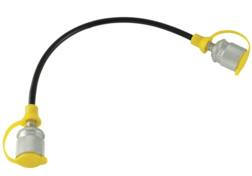

I use big 4" face liquid filled gauges, 0-300 psig and 1/8" braided hose for pressure tests. Alternately, 1/4" AC gauge manifold hose is rated for higher pressures lately. Spend a little on good gauges.
The below type hose is what I am using, a little over-rated at 400 Bar but the good part is the port adapters come with integrated check valve.
So you simply replace the 1/8" NPT plug with those and you only have to swap the hose over without removing/installing fittings and plugs.
When you are happy with everything just reinstall the plugs.
