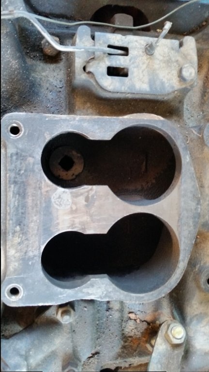

This is a 4 hole manifold correct
That is a very strange manifold since it only has two holes for bolting down the carburetor. Sure it's not an industrial one for propane or some other thing? How about a picture from a little further up, showing more of the manifold?
Its a spreadbore manifold. I bought an adapter. I didn't concentrate on the whole manifold as I was curious about the hole not the bolt holes
So there are a total of 4 threaded holes for mounting the carburetor, even though we can't see the other two?
No, sir. A 4-hole manifold would actually have four separate holes.
I have never seen one like that before...primary and secondary cut together...maybe each side fuels each bank on the motor? Not even sure what carb fits that.
Maybe one of the other guys will chime in for you on that. Might be looking at needing to use an adapter plate (to match up with the carb you want to use).
The other bolt holes a are cast separate and not in the pic...
