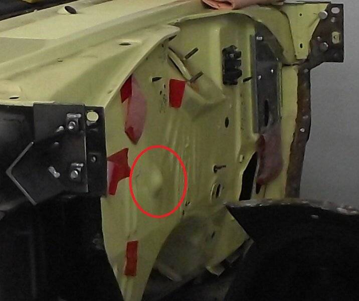

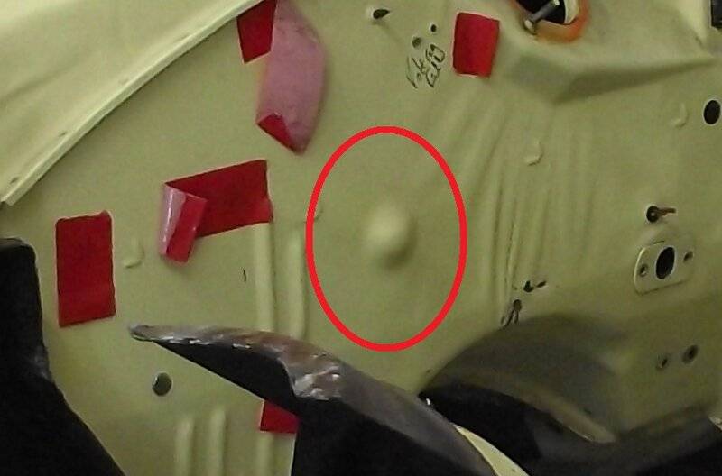

If they smoothed the firewall, did they also get rid of the small bulge for the blower motor? If so, then you'll need to do a bit more work to get a stock heater box to fit. See attached.
april 2014 001 (2016_11_22 02_37_15 UTC).jpg april 2014 002 (2016_11_22 02_37_15 UTC).jpg

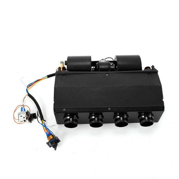

I saw a few different ones from Jegs that fit under the dash. I am currently working on a Square body Chevy with the same situation, somebody took out all the under dash stuff. When I saw this post, I googled it and that's what popped up. They look pretty good and simple to me... at least for a truck, probably for a car too.

Appreciate it but since the fire wall was smoothed the indents for some items are no longer there. Not gonna redent it….its too nice.
Yup the one from VINTAGE air is similar. I think I am gonna pass for now as I have enuff projects goin on with the car so I will wait.
Looks like it still needs your hoses from the water pump to work.
