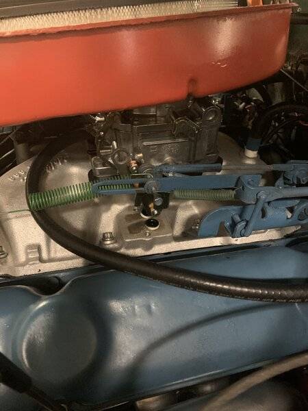

So I just got this 1407 from a buddy to place on my 2186 dual plane. I added the 1481 throttle adapter but still no kick down. I'm not sure what I'm missing, but honestly to me all this adapter seems to have done is move the linkage further away from the carb. I had to block off the EGR to use it. I'm about to ditch it all and go with a BPE torqueflight kit. I used one of those on a 73 Charger I used to own, but anticipated linkage issues when I changed that from a 2 barrel to a 4 barrel car. I didn't think I would have any issues here. What am I missing to make this linkage correct?

Whenever you move the linkage bracket you need to re adjust the length of the kickdown rod. 2 to 4 bbl conversions require that you lengthen the kick down rod.

The bracket moves it away from the carb, and lower and back a bit. It really is a good thing to have on there.

Yes, worked like a charm with the 600 CFM Carter that was on the car before.
You need to check it at the transmission and see if the lever is all the way back at full throttle. If not, you may need to modify the linkage rod. 440'

Read your Factory Chassis Service Manual, transmission section on linkage adjustments.
Pages 725-727
Thanks, but don't have one. Mymopar only has them through 73. I do have a 74 parts catalog that shows some linkage illustrations. Will figure it out. Most of the pictures I've looked at seem to indicate I have everything in the right places.
