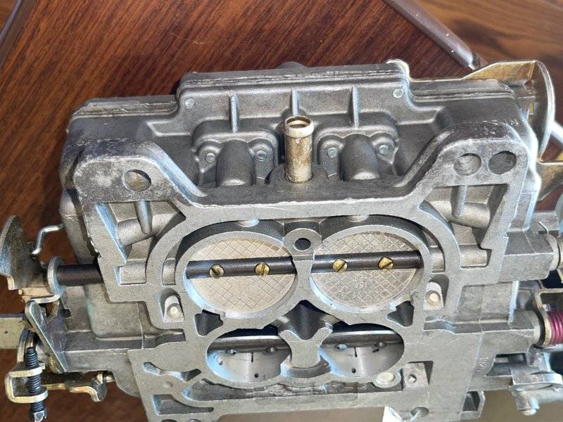

Put your vacuum gauge on the hose end that goes to distributor vacuum can. Does it register vacuum? If no, attach directly to the carb? Either hose is clogged or the vacuum slot in the carb to the tube is plugged/clogged. Picture show slot on the right side primary. Hard to believe it is clogged, but tube migh have something in it and hose could be plugged. Folks use to use ball bearing to plug vacuum hose for performance while retaining stock look.
Thanks for your input. I have tried both with and without the hose and no vacuum at any RPM. I agree that it’s odd for that port to be clogged. I like some of the previous ideas also, I’ll try all of them until I figure it out. Keep the ideas coming. Thanks, everyone

If you have no vacuum at the nipple on carb. Shut motor off. Open primary wide open, place catch rag/towel under bore slot for vacuum. Shoot carb cleaner through the vacuum tube. Should come out the slot. If you get a lot of dirt/grit. I would remove carb and thoroughly clean. Have rag around nipple too. If clogged the cleaner is going to kick back.
