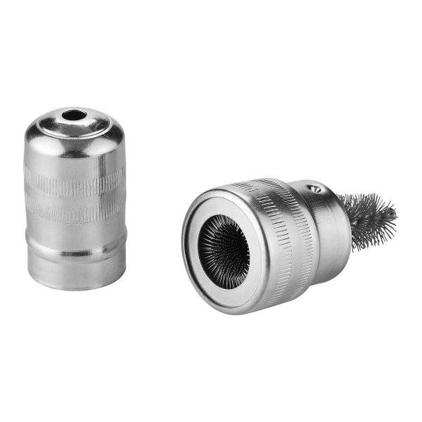

Battery Terminal Cleaner

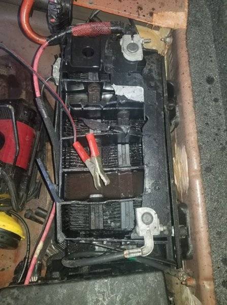

A coworker had a tender on his Corvette, hit the starter and the battery blew up. Exploded into pieces soaking the whole engine bay with acid. Apparently it was a constant voltage unit.
The only tender I've used was for the jell battery I had in my Harley. If it wasn't used that battery would go dead. I've never used one on the Exide battery in my '62 and I've never had to charge it in the last three years. I just leave the negative cable disconnected when not in use.
Yep.. I've cautioned it many times here on deaf ears. Leaving tenders and battery chargers hooked up constantly is fine until they go rogue on you, boil a battery partial dry and turn it into a hydrogen bomb. A friend of mines newer Challenger that he left a tender on...

I just quickly googled "boiling batteries turns them into hydrogen"... as I need to get to work. My buddy above pulled the charger clip off to supply the "spark". Here's the blurb..
"More often than not, if you overcharge your car battery, it simply dies; that’s how manufacturers nowadays intended to fix human error. However, older batteries have more dramatic side effects. As a car battery overcharges, the sulfuric acid and distilled water mix starts to boil. The heat and pressure of this boiling acid/water mix will start to make the battery casing swell; in some cases, the heat of the mix will start to melt the plastic casing, which, in fairness, is the best case scenario for this context, because the alternatives aren’t any better.
If the boiling acid/water mix isn’t a problem enough, flammable hydrogen gas can start building up inside the battery’s fuel cells. This gas can either swell up the casing or start seeping out through small fissures. Once the hydrogen makes contact with oxygen, you’re basically sitting inside a sitting time-bomb, where the smallest electrical spark can ignite the gas and explode the battery, sending toxic lead-laced shrapnel everywhere, not to mention spew out a spray of caustic sulfuric acid."
