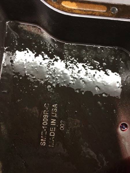

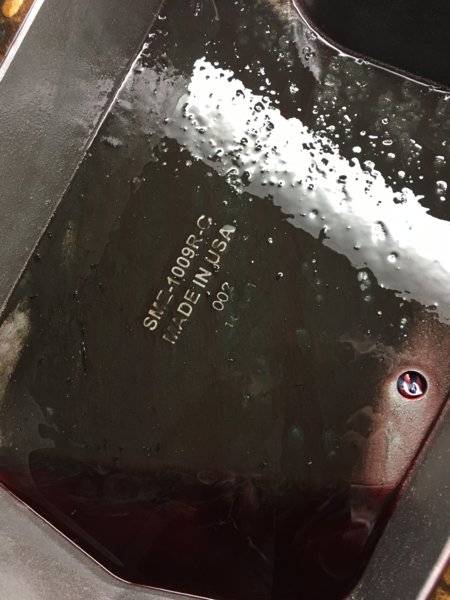

Dropped the pan and this is what I found. It’s a powdery substance on the bottom. Filter has shavings on it.
BEEB220C-7E2E-4553-8B8B-1E12D3A0C60A.jpeg F0764639-0F5C-48AF-8B3E-7E81CCCDC74C.jpeg
Is there lots of play in the rear band. It may be out of adjustment if the lining came off of it. Then the rear band is toast. Kim
Front clutch is used only in Reverse and 3rd. What's the history, new trans or been working and the problem just started?
