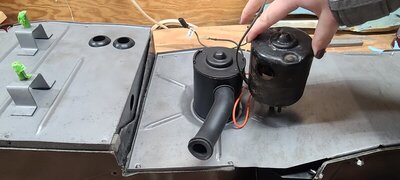

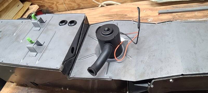

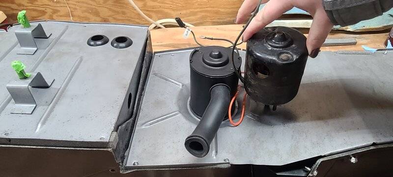

Good Morning All - Been working on my heater box restore and seem to have run into a snag. The aftermarket heater blower motor has the cutout for the cooling tube more around the 6 o'clock position where the original armature has it around 7 or 8 o'clock. I believe this small degree of difference is what facilitates the cooling tubes connection to the heater box back panel. Is there a different hose that I can buy to make this connection? or am I missing something obvious?

Take the guts out of the new motor and put them in the old motor. Why did you need a new motor anyhow - the old ones are fully rebuildable.
Thanks Stanton. I appreciate your insight, seems easier to get a longer piece of hose.

Hey Dan - yeah, I cut my factory hose in the middle & found some slightly smaller hose to fit the two ends together to bridge the gap. Then heat-shrink tubed it together. It took a bit of doing to get it fitted without kinking. But ultimately I'll probably have my motor rebuilt so next time I pull it I can put it right.
