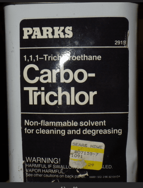

Way back when I magged aircraft and locomotive piston pins for a living, we were washing them in a large vat of trichlor. We used it by the drum................... for years.
Just finished up my last store bought home use can recently from the early 90's.......
