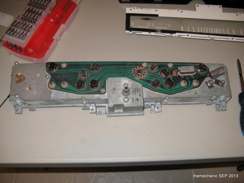

I recently refurbished my non rally instrument cluster. The circuit board appeared to be good . So, I cleaned the contacts, installed a solid state voltage limiter, and LED bulbs. I had the switches rebuilt, including the dimmer. The right side instrument lights come on with the headlight switch and dim with the dimmer switch. However, none of the lights come on the left side. I swapped one working bulb from the right with one not working on the left and the one bulb on the left lights up but no lights work on the right; even the ones that worked before. I replaced all the light sockets with new ones. I also ensured I have a good ground. Short of installing a new circuit board what is the solution? :BangHead:

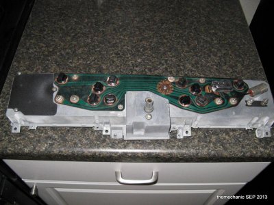

Here are the before restoration and after photos:

....... I replaced all the light sockets with new ones........../QUOTE]
Your problem is the NEW bulb holders. The contacts are slightly different and when you twist them on, you are not making contact with the circuit board trace. Go back to the original style bulb holders.

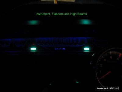

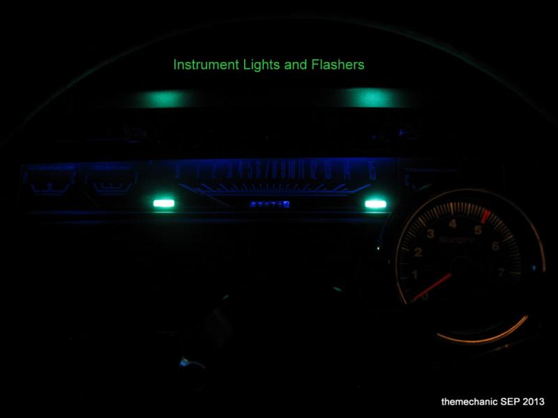

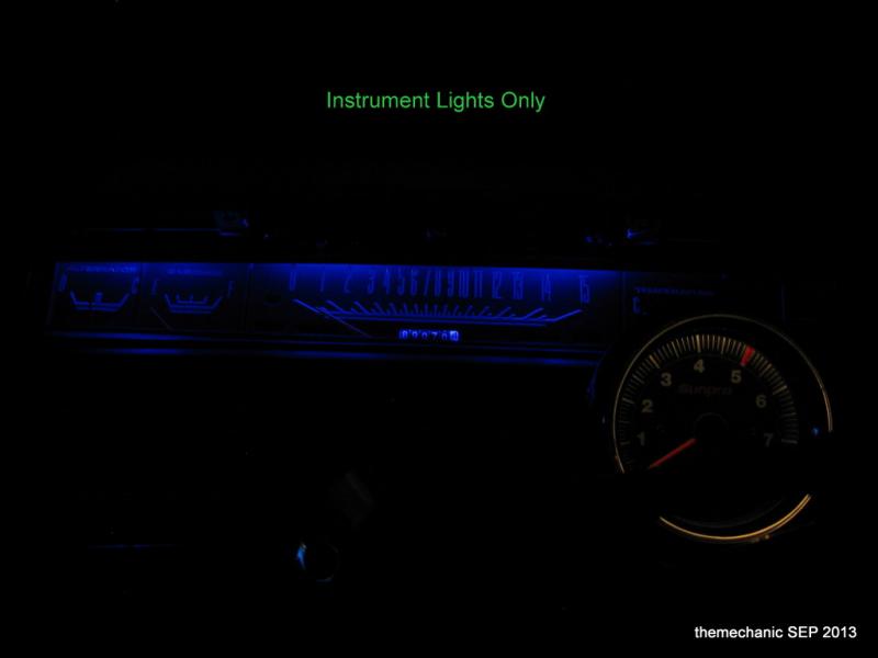

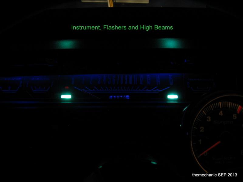

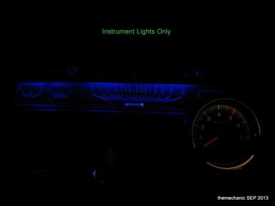

*****update*****
MNBIKER WAS RIGHT.
I started by removing all the light sockets. Then, I bent the metal tabs up on each side to make good contact with the PCB. Next, I plugged one light in the far left instrument light whole and it lit. Then, I moved to the hole to the right but the bulb didn't light; rotated the socket 180 degrees and the light came on. I then repeated the same for all the light holes until all the lights worked. Hallelujah!
Thanks mnbiker and FBBO brothers.
Enjoy the light show.
*****update*****
MNBIKER WAS RIGHT.

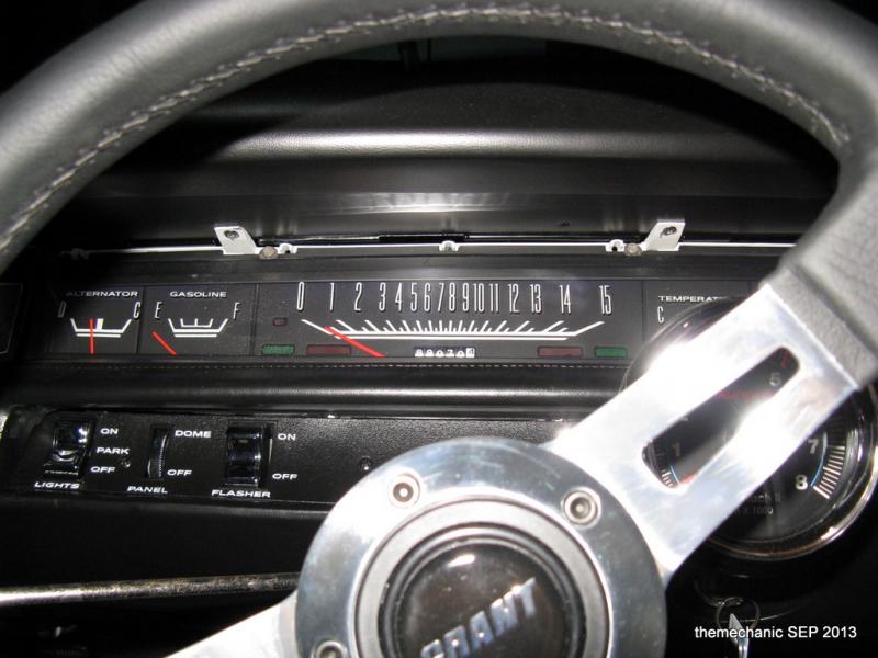

Looks like your fuel gauge got cooked, (your old limiter was probably bad)....shouldn't be sitting that far to the left, I bet if it works it isn't accurate. What I do on all the clusters I work on is solder all the pins on the circuit board,(you don't need to buy a new circuit board like everybody thinks), I've fixed more problems by doing this alone....if you can wiggle those pins at all, there'll be a problem sooner or later.
Yes, the fuel gauge reads on the low side. I may have messed it up when I removed the needle to paint the face black. It's a booger to R/R those little orange needles.
