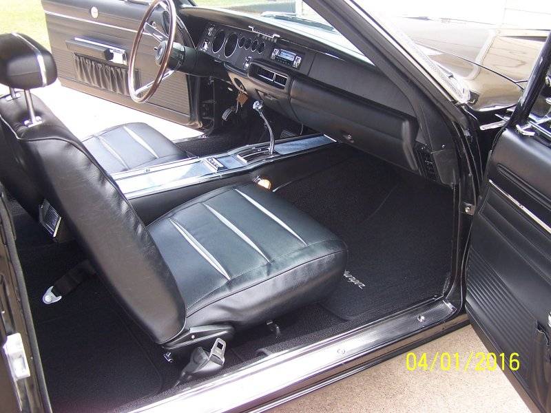

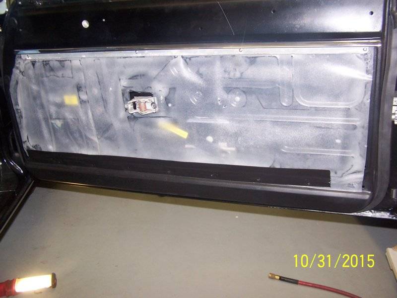

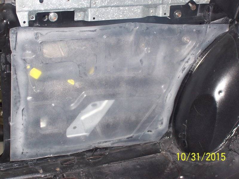

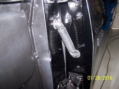

Nu Relics is the only player I'm aware of that is making the power regulators for the rear quarter windows. I installed their system in my 68 Charger a few years ago. I'm not going to be any help with mounting the switches in the door panels because I bought new door panels without the holes cut in and I only have the gang switch for all 4 windows. I mounted it in my console so no individual switches. The wiring for their system is real simple and only needs a power 12 Volt power feed. No relays like the factory used. They provide a tube to run the wires for the doors and the wires for the quarter windows run in the channel under the carpet and there is a space at the bottom to run the wires into the quarter window area. My only problem with their regulators is they did not have a adjustable stop for the door window down position and I had to fabricate one for mine. I'm not certain that they fixed that problem or not. My window would go down below the cat whisker about 1/2" too far. Here are a few pics of my install.

That looks really nice. I don’t have a console as it’s a bench seat car. I also don’t want to drop the coin on the door panels as that doubles the cost of an already expensive install. The panels I have are in decent shape and “good enough” for the purpose of this car. It looks like I can trim some sheet metal and also space the regulator back enough to fit the switches in the original hole locations. It’ll be a bunch of fiddling, but should work. I’ve got both driver side windows in and they work great. I’m gonna like these when sitting in the staging lanes in the heat.
