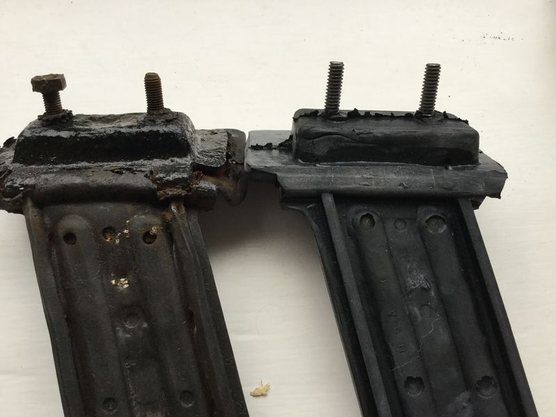

Hi, what is the correct nut size for the repo gas pedal from Summit for the 66-70 B bodies? My original nuts don't seem to fit, I didn't want to force them and mess the thread up.
I think the stock ones are 10-24, but if they don't fit.... just take your new pedal to your local hardware store & try the various nuts our for free....just a thought.
We are metric over here and the diy place in town has limited stock so no imperial nuts. The studs on both my original pedal and the new one measure 4/16" or 7/32" ish in diameter, do I need 10-24 for around this size? Sorry I know nothing about imperial sizes. The thread on my original pedal looks a lot finer, as in more threads in the length than the new one.
These are my old and new pedals to compare
Your new pedal looks like a U.S. 1/4 x 20 thread. Quite common here.
XP29: You're correct. I'm replacing my pedal and see the same situation. The original was a 1/4 x 28 but the replacement I bought is a 1/4 x 20 thread. The 1/4 refers to the diameter of the bolt shaft in inches and the second number is a U.S. measurement of threads per inch. This is such a common bolt & thread in the U.S. that I would "think" you can find the 1/4 x 20 nuts in the U.K.
I have emailed them, but just incase I don't hear back. What do I need to search for when looking for nuts? Will 10-24 have the fine thread as my original?
ok, thanks for the reply. So I search for "1/4 X 20" ?
mine are all 1/4-28. and are keps nuts.
Is the 28 referring to a fine thread? I'm just trying to my head round the imperial nut's and bolts and the different threads.
28 is fine threads. 20 is a coarser thread & the one that will fit your new pedal.

i had a mail back. They are 1/4 20 threads. I found some on eBay which are in their way.
